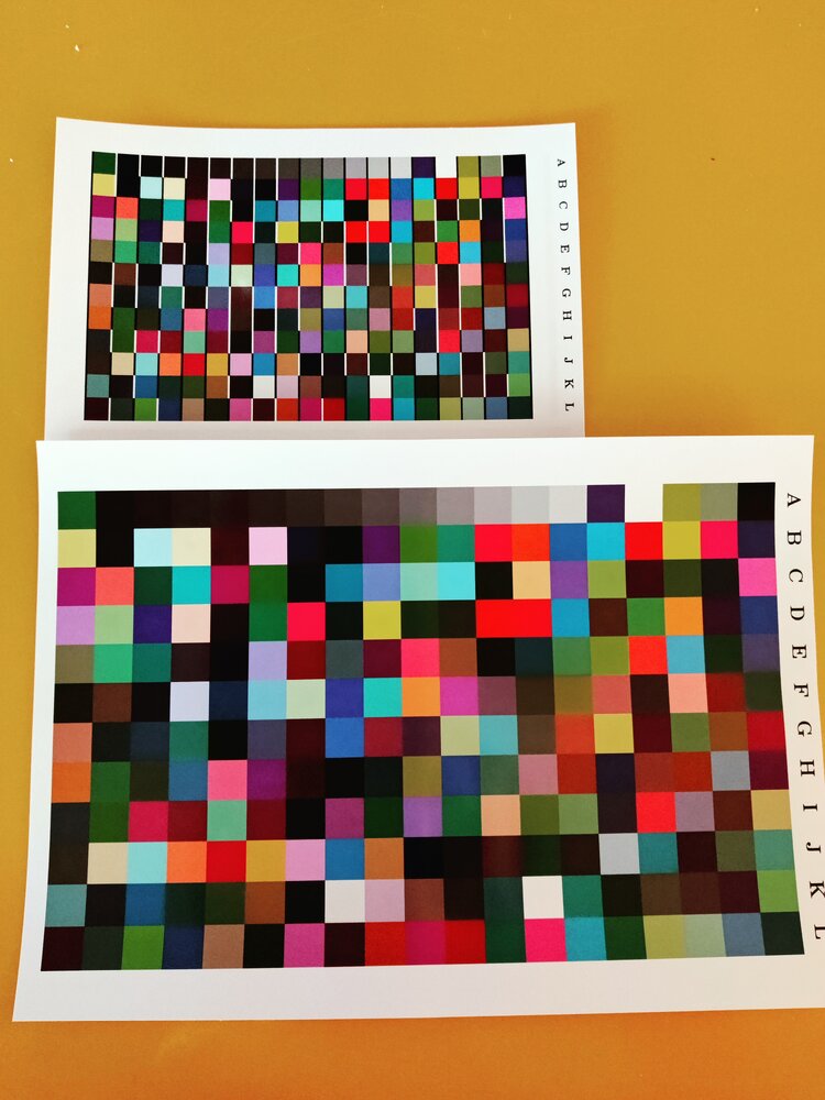

many thanks for all the work @x64 : I wil give it a try with another type of paper of which I already have profile made for a side by side comparison to see if the CR30 colorimeter is a feasible alternative for a poor man's printer profiling solution costing only about € 70.-. For this I have do some test to compare thos profile side by side in prints.

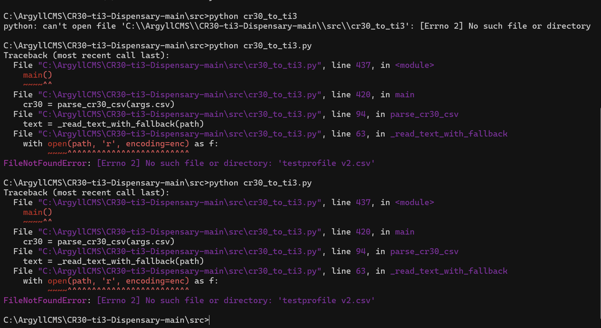

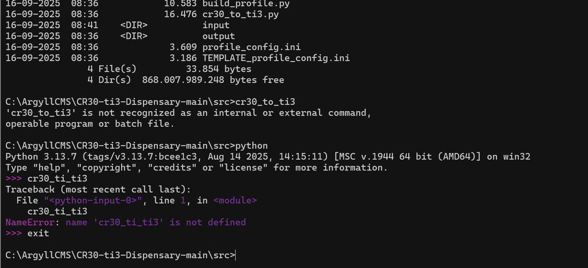

Hi @x64 : I am a noob using python because for me it is a bit cryptic how to type in the commands to start the py file.
I tried this, but it does not seem to work:
Enlightment much appreciated.....
Meanwhile I will print the target (both the CR30 and the i1Pro version) again on a totally different kind of paper (the previous was Calumet matte photo paper) which is a cheap glossy cast paper and this time on the ET-8550 to see if the magic is still there. First I will generate the profile using my i1Pro1 and save this as a comparison profile for a later side by side comparison with the CR30 read target.
As you can see the same layout order in both the small patch (with space bars) for the i1Pro and the large patch CR30 colorimeter target.

OK found how to type in with python, but unfortunately the computer says NOOOO:

I forgot there are some caveats with python on windows, but I think you should be able to run the scripts.
The build_profile.py script is meant to be the main entry point. This script uses the profile_config.ini arguments to run the cr30_to_ti3.py directly, so you do not have to provide arguments for running the conversion.
You could run it standalone, and works fine, but you have to provide it specific arguments for your input/output files, otherwise it tries to find and use example files (that do not exist anymore, testprofile v2.csv is a old filename, my bad).
There might be additional issues with the ArgyllCMS installation, but that should not influence the CSV conversion.
To rule things out, first download the latest release from github. Remove previously downloaded versions. After extracting it, navigate the terminal to the src directory (you did that correctly looking at the screenshots).
Then simply run: "python3 build_profile.py".
With the latest release, all example files are in the correct location (this is defined in the config), and should run and deliver at least the output_example.ti3 to the output directory.
