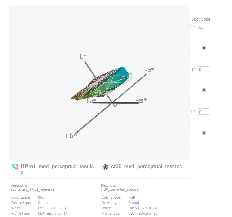

I'm getting some results, can generate icc profiles from converted csv to ti3. Difference between i1Pro1 vs CR30 seems reasonable, but for some reason the profile gets flattened at a certain threshold on L*. Is this the profile you are expecting?
This appears in both the known good i1Pro1 ti3 and our converted data ti3, so it's probably me configuring ArgyllCMS incorrectly.
I attached the converted ti3 for you to try, please try so I know how to proceed with the script.
actually not, that should not be the case. It should like a inflated pear.
I get the same flattened pane when processing your i1Pro1 .ti3 with ArgyllCMS. If you get a nice profile with the i1Pro1 .ti3 you shared, please tell me what arguments you used so I can reproduce it.
I use this setting:
colprof -v -qh -i D50 -o 1931_2 -S AdobeRGB1998.icc -cmt -dpp -D%par1% -C%par2% %par3%
I'm breaking my head over this, using your provided i1Pro1 .ti3 that you made with ArgyllCMS, the resulting icc generated with ArgyllCMS gets the flattened pane. Are you sure the i1Pro1 .ti3 you shared can generate a desirable icc? I am able to generate proper icc profiles using my own ti3 files just fine
Even with your exact command and import of the adobergb icc we get the same result as shared previously.
I use this setting:
I see the reference 228-target.ti3 (with my i1pro1) is not ok. I will upload it again. Please use this new ti3 als a reference to create the new ti3 using the scan data with the CR30.
