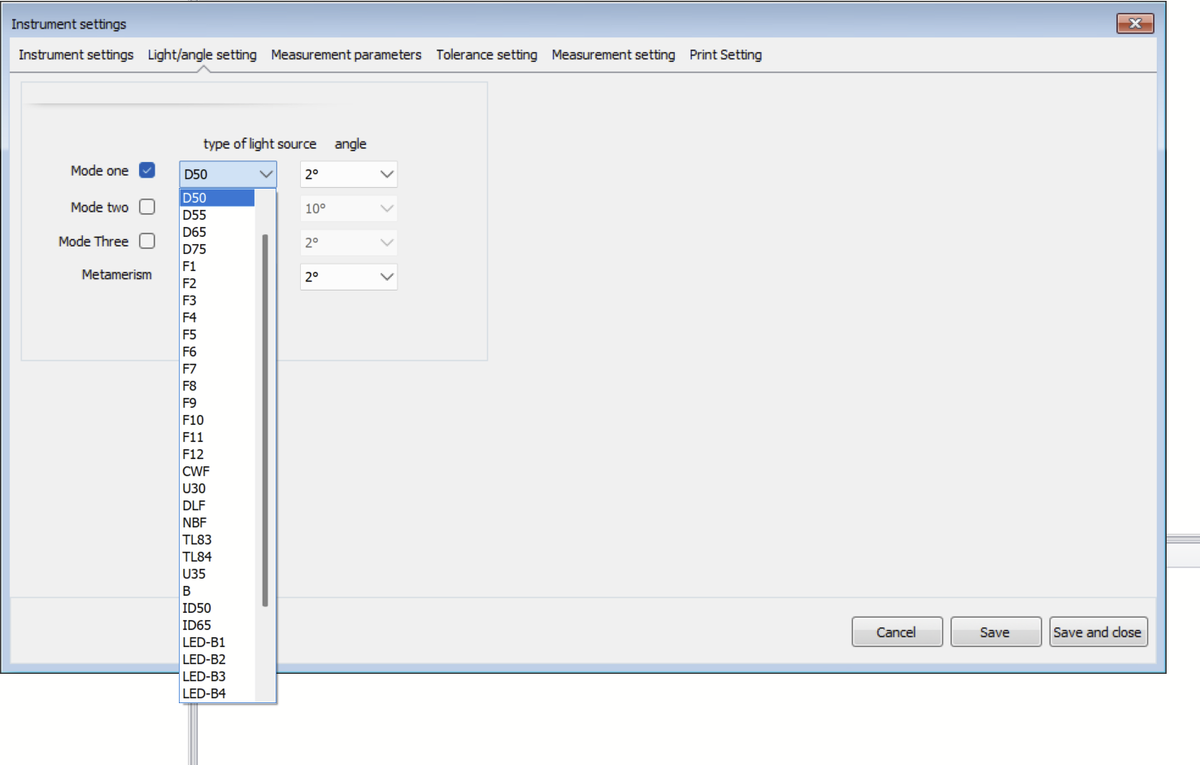

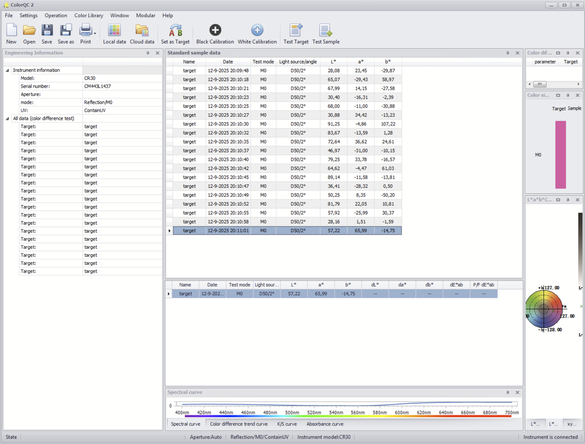

The software under Windows gives this as scan values:
There is no much information about how to use this device: I have chose M0 /D50 at 2 degrees angle . Not sure in the UV-setting I should choose UV400 or not ???
Anyhow It picks up the color patches in LAB values.

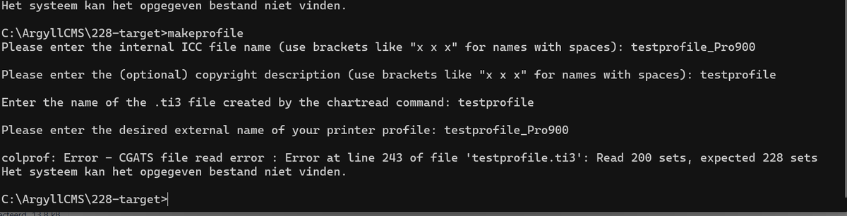

I got this when trying to create the profile:
It reads only 200 sets and expected 228 sets.....
I changed some description too like Colore Rep into iRGB_LAB (was i1RGB_XYZ).
The file says NUMBER_OF_FIELDS = 7 while the DATA_FORMAT statement has 8 fields.
228 * 7/8 = 200
Looks like it just reads data elements according to the data format ignoring new lines.
Are you sure argyll needs RGB and XYZ values anyway? If you can generate them from Lab then argyll could as well.
It looks like chartread with -L and -n switches creates a ti3 file with only Lab values. I presume if such a file isn't useful it wouldn't allow creation of it.
In my example, the NUMBER_OF_FIELDS is correct:
SAMPLE_ID RGB_R RGB_G RGB_B XYZ_X XYZ_Y XYZ_Z (7 fields)
Pharmacist introduced SAMPLE_LOC to the configuration (field 2 out of 8) but did not add the location index to the sets:
1 0.00000 0.00000 0.00000 7.404274 5.772079 12.826289 (7 fields)
But the SAMPLE_LOC field is optional, and out of scope for what we are trying now.

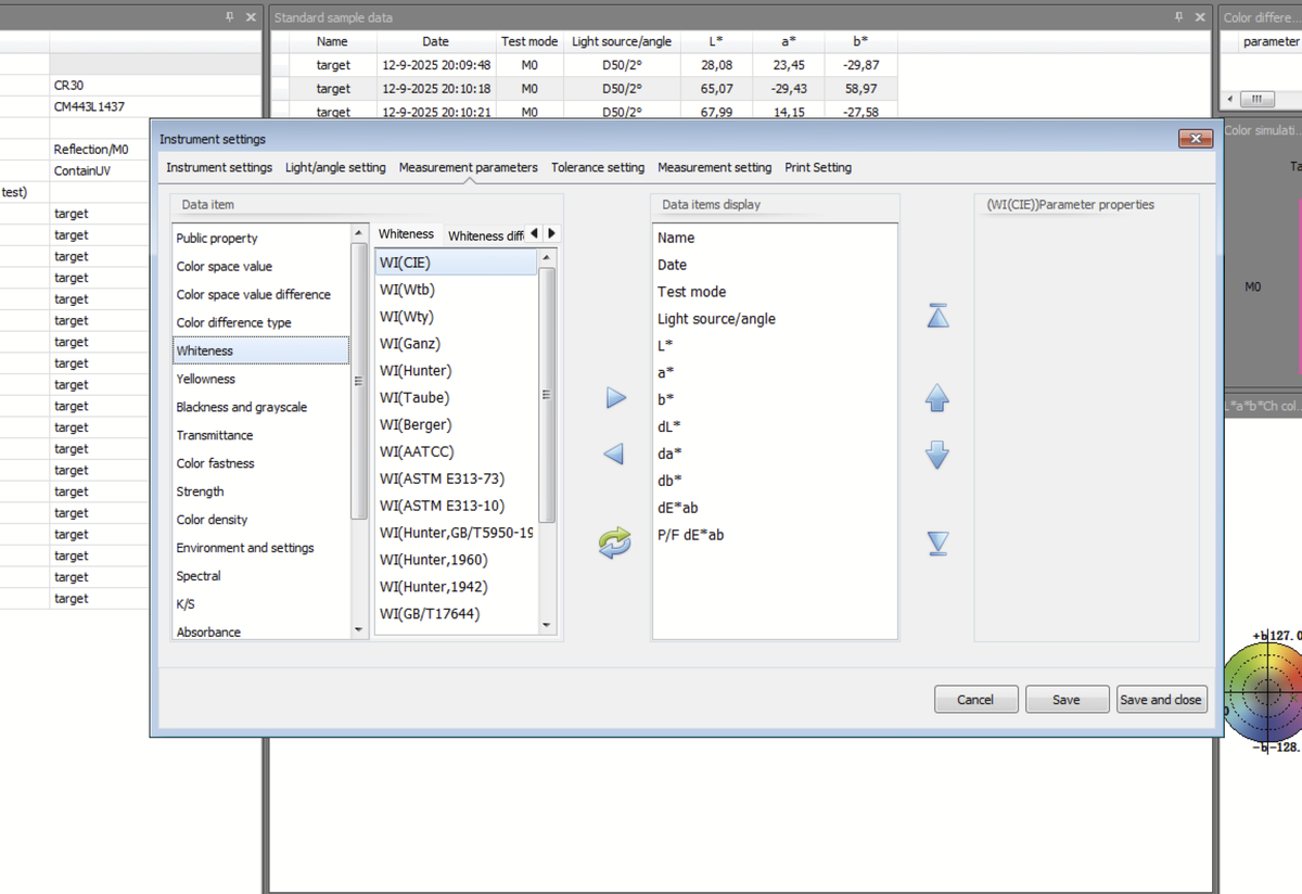

Looking at your screenshots this spectrometer can create a lot more output than what you produced with the current config (e.g. spectral data). I took a quick look at the .ti3 specification and we can definitely generate straight from lab with argyll. Do a deeper investigation of what data we can produce with this spectrometer, what argyll accepts (and in what format we need to provide to comply)

Could you share another scan csv but with spectral data so I can include that for you. Because the CR30 is not included as target instrument (so no illuminant spectrum preset) we can avoid inaccuracy by including the sample spectra to Argyll directly.

Hi @x64 : Is will try to rescan the target again and include the spectral data from 360 to 780 nm in steps of 10 nm and also the necessary LAB values.
