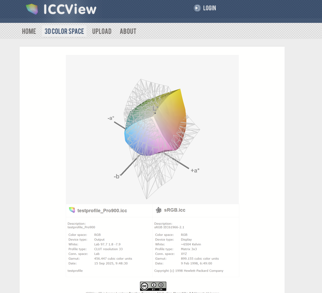

This is how the profile should look like:
3,232
1,848
333
SC-900 ET-8550 +18100 WF-7840
I think I messed up all the files, so this is the correct set of data: ti1, ti2 and the ti3 that is scanned with a known spectro: i1Pro1 (to be used as a reference file to build a new ti3 using the date from the CR30 obtained scandata in csv-format) + the csv-file based on the LAB + spectral data from 400-700 nm obtained by scanning with the Aliexpress CR30 colorimeter.

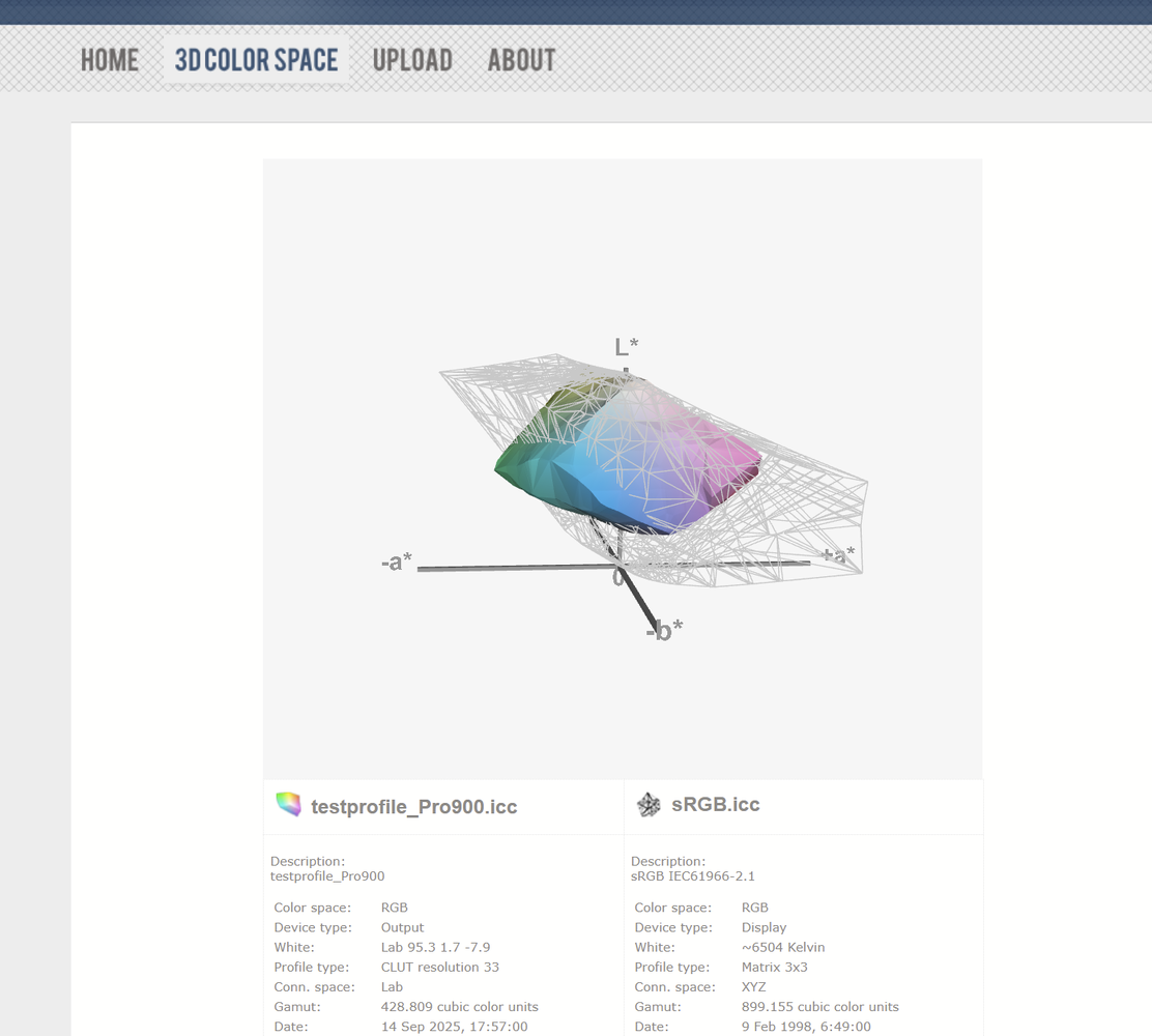

This is the profile 3D model when using the right ti3 file:

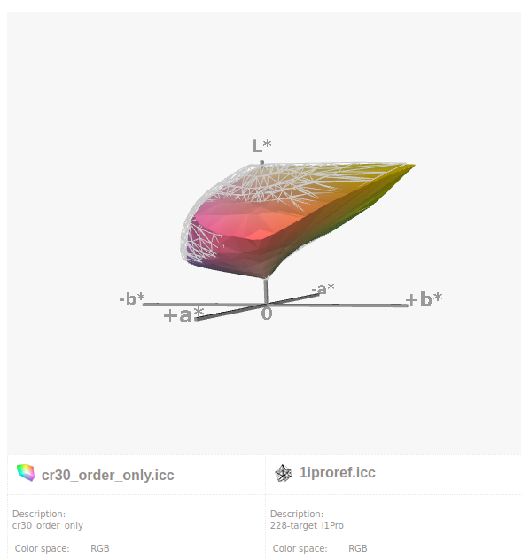

First results looking good! I'm noticing some difference between the 1iPro1 and CR30 results. Not sure if this is an undesirable offset caused by our process, or just instrument measurement difference.

Hi @x64 : that is some fantastic job you did. I think the difference is totally explainable. The i1Pro1 ref ti3 is reprinted with a smaller patch size and scanned (but with the same patch layout) and scanned on a yellow table and the CR30 target was printed on a table with a mousepad with greenish pattern underneath. The difference should be acceptable provided the two profiles have more or less the same 3D-body with the some curvature in each XYZ-axis, but a bit smaller or larger is ok.
I know I can cramp extra 19 extra patches on a A4 paper to make up 247 patches, so maybe I will redo the job with 247 instead of 228 patches increasing sampling rate in the RGB color space. The Spyderprint High Quality target has only 225 patches, so 228 should be enough: What I will after you have uploaded your script, is to reprint on a different paper (gloss) and redo the trick and compare it to a profile made with a larger patch set (maybe 648) and using a i1Pro2 and ArgyllCMS and compare those two profiles and see if the magic is still there.
At this moment it looks already very good: that is a great opportunity for a poor man's printer profile. I am pretty sure the device can be used to calibrite a screen as well with the necessary scripts in ArgyllCMS
