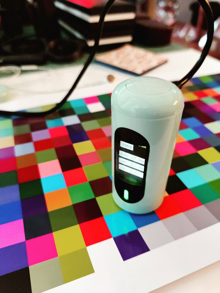

This is the CR30 colorimeter that costs about €55-60 (depending on the offers at aliexpress,the price can fluctuate but 55-120 euro, so look carefully at the offers because the price differs greatly). Also be sure to choose the CR30 als the CR10 and the CR20 are less accurate.

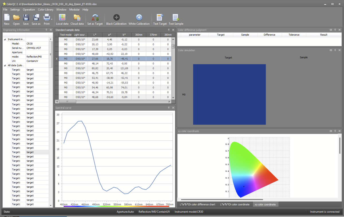

The CR30 patches are read with the ColorQC2 program that registers the LAB-values and also the spectral data from 360 to 780 nm in steps of 10 nm and is a LED lamp based colorimeter:
The data is exported in excel .xlsx and later converted to a .csv (comma separated) file in excel, because there is bug in the ColorQC2 program does not export well.

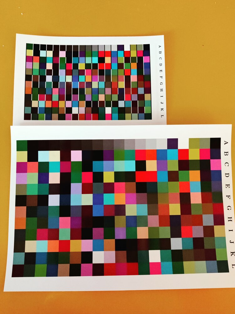

For control/comparison I also printed exactly the same target (but much smaller patches and with separation bars) to be scanned with a vintage i1Pro1 (lamp: tungsten):
Below a sample with on top the small patch i1Pro target and below the exactly same target with large (14.7x14.7 mm) patches for the CR30 colorimeter:

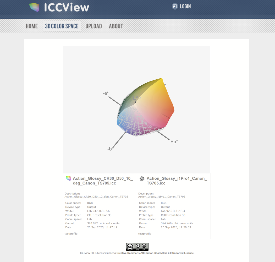

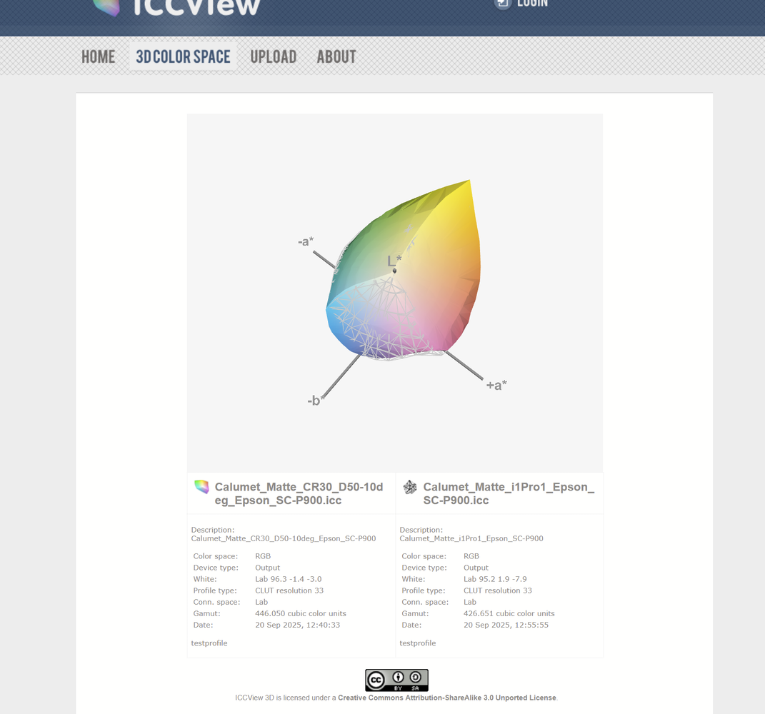

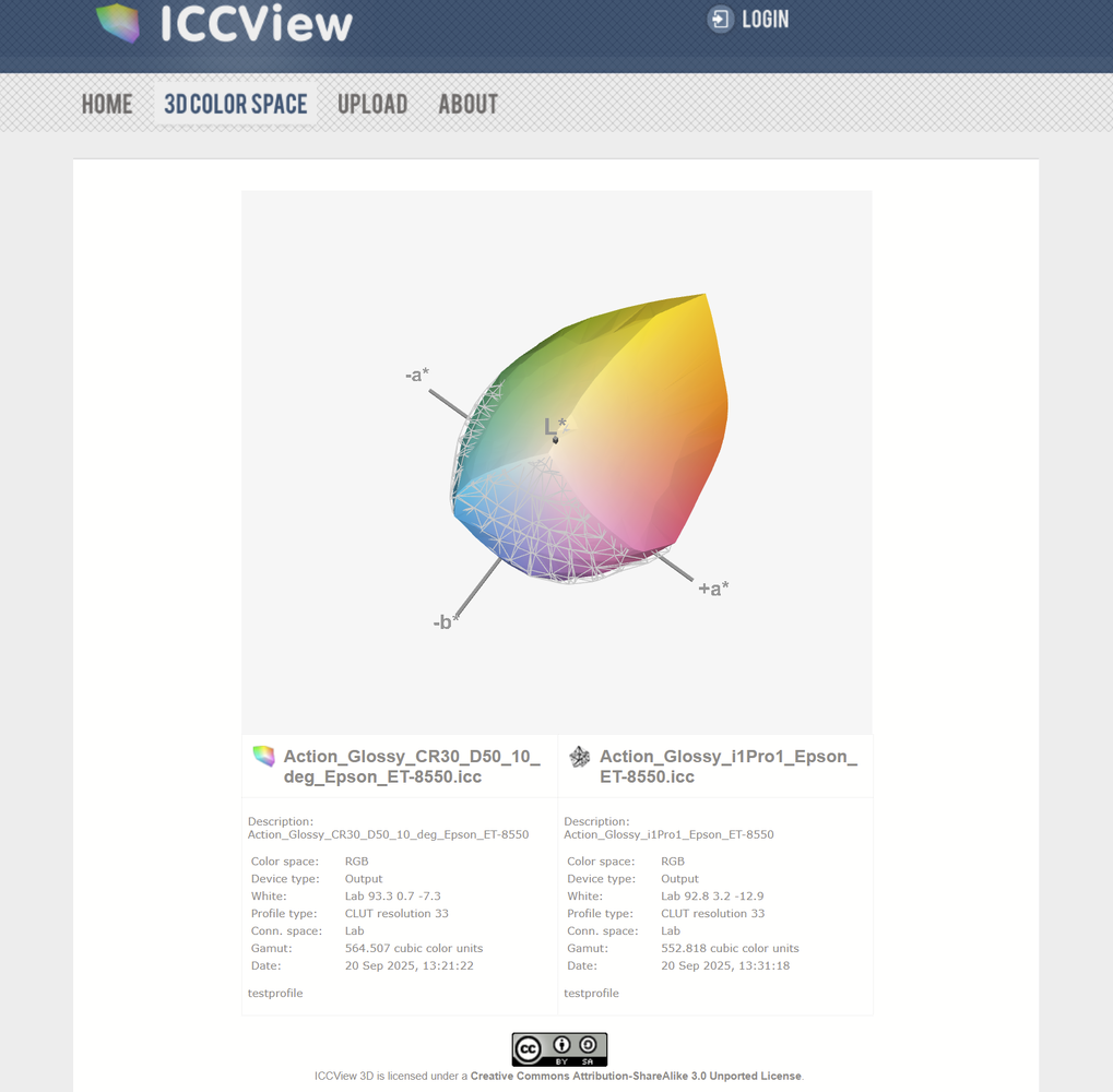

Here same print screens in iccview.de (below you can download the 3 profile sets: each set is for the same paper/printer combination but with 2 different profiles of which one is read with the i1Pro1 and the other with the CR30 colorimeter for side by side comparison in iccview.de)
Have a look the white point values and the gamut volume between the two twin profiles: they are very similar in value and shape/size. You can download the profile sets below for a 3D view yourself for comparison.
