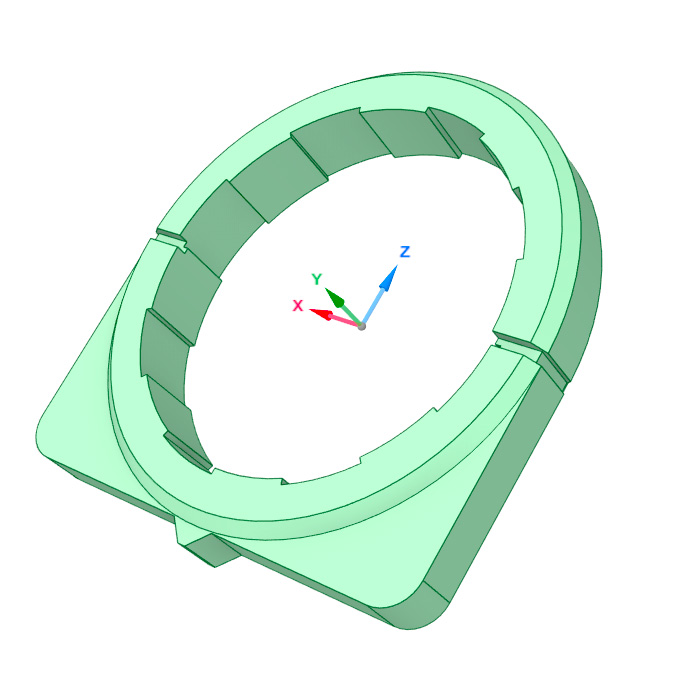

I think with care you could go smaller than 15mm square patches. The hole in the bottom of the CR30 is only 5mm.
If I do end up using the CR30 for printer profiles I think I would print a collar for it something like this
and a rule with notches matching the patch pitch.

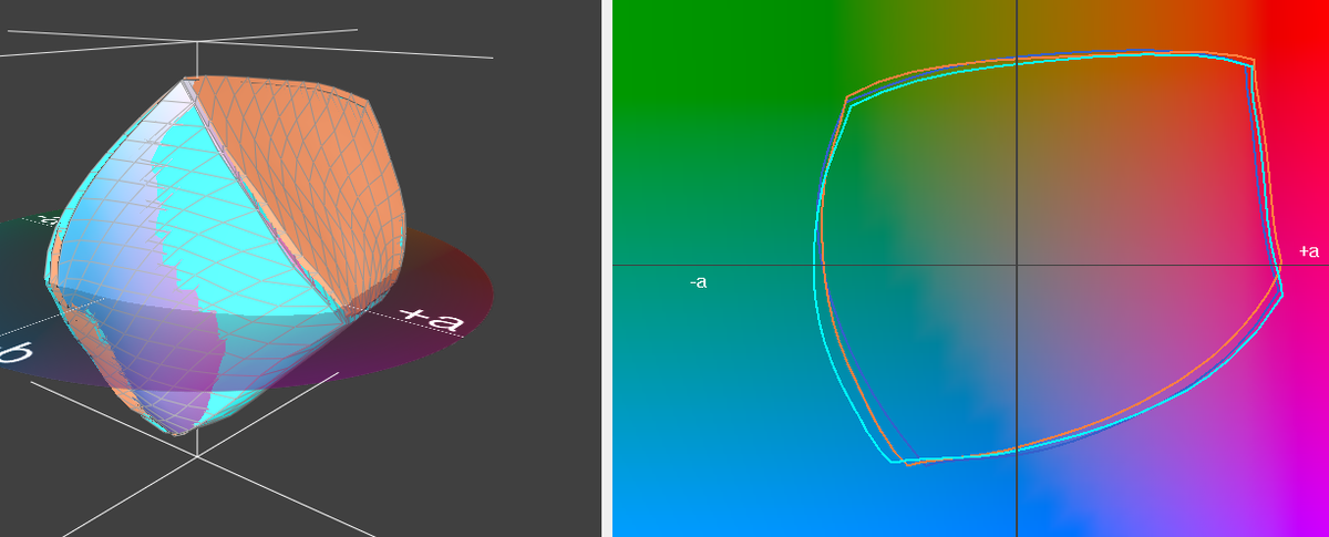

Let me compare the profiles with a profile I did some time ago with the Action glossy paper on my ET-8550 running with Epson 106 inks; I was using an A5 patch sheet with 283 patches at that time.
These plots show how the profiles compare at a mid luminance at L*=50 as an horizontal cut with
light blue - I1Pro1 scan
orange - CR30 scan
dark blue - I1Pro2 scan
The overall gamut volumes are pretty much identical, there are areas where one or the other profile is just slightly wider

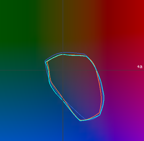

The overall look is the same at a darker luminance of L*=25 , we are here pretty much at the bottom of the gamut volumes, all 3 profiles are pretty much identical.

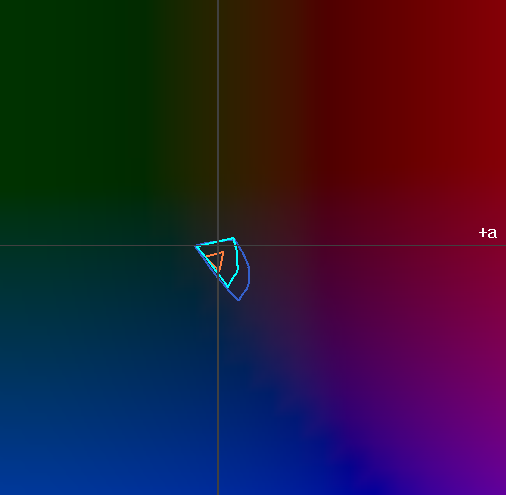

There are slight differences at the bottom tip - here at L*=15, the black points are between 10 to 12.

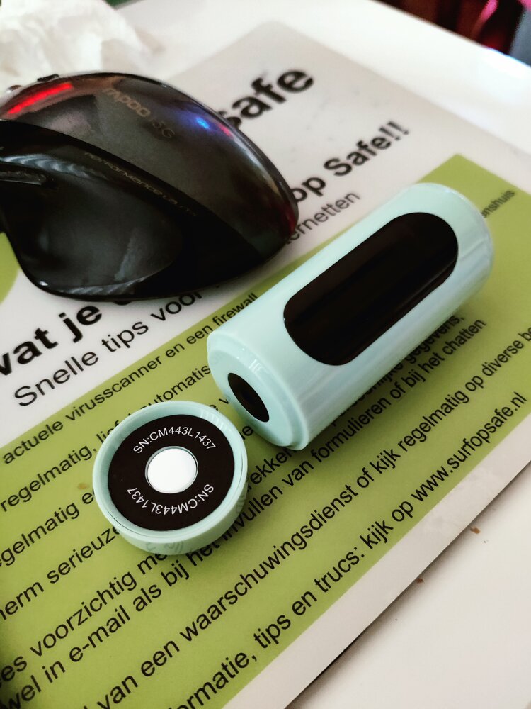

yes it has a white tile to calibrate on:
it is magnetically attached on the spectro.
I think printing a special mall that uses the adjacent patches as kind of reference to clearly define the position of the scanning hole is feasible,
With a collar like I suggested and a patch pitch notched rule you would only have to align the rule for each column the CR30 would just be slid along to the next notch.
My calibration patch reads 89.44 -0.71 0.12 (D65 source) is yours the same?
The documentation is pathetic.
I just noticed the back of the calibration cap also reads 89.44 -0.71 0.12. The device detects the magnet in the cap and button presses become white calibration operations. You would think it could do a black calibration at the same time by not turning on the LEDs but it doesn't.
A black calibration initiated in the windows application seems to be stored in the device and retained over power cycles.

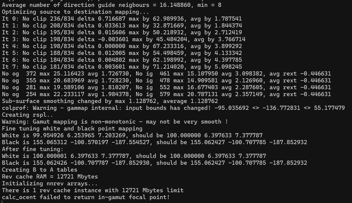

ok today I tried a newer 247-patch target and unfortunately there is an error when executing colprof:
The message:
warning: colprof: Warning - gammap internal: input bounds has changed !....
@x64 Could it be there is a conversion error from mapping the ti2 file to the csv file to generate the ti3 file ?

Mine reads a white point of the tile: 91.22 -1.09 0.17
probably not a concern, as each tile is bound to each individual spectro.
The message:
Maybe you can have a look at those 2 files if you have some time and try to generate the target yourself:
Something with the gamut mapping the source ICC, when running colorprof with no mapping (no -S/-s) I can create an ICC with that dataset (although it does not look correct).
I'm not sure what that target looks like, is there enough dark patches for contrast? the issue is mostly low contrast in the measurement set from what it seems like looking at the logs.
I will try to reread the target again, because maybe the problem is on my side. Normally the distribution of the test samples should be ok, as the targen.exe argument -G is enabled (good distribution). I will give it a try again and report back.

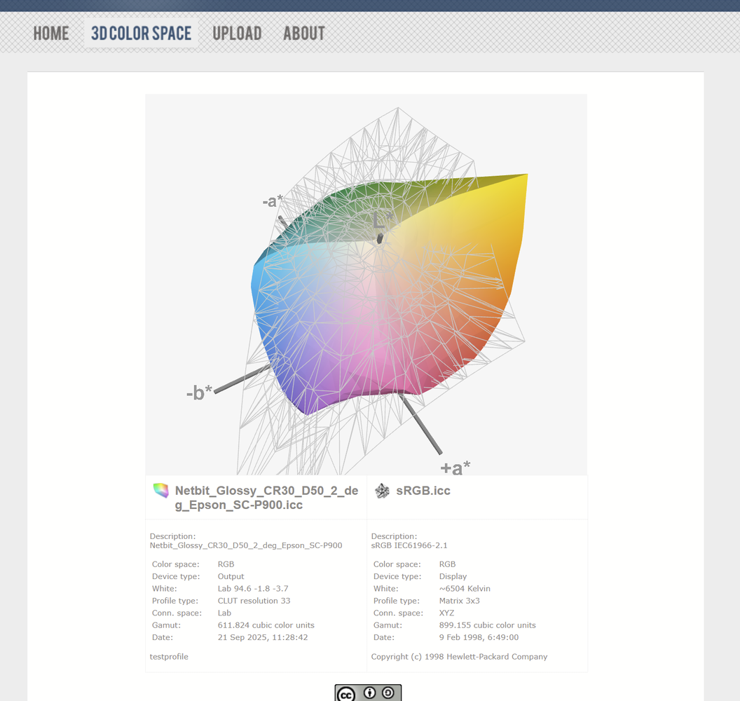

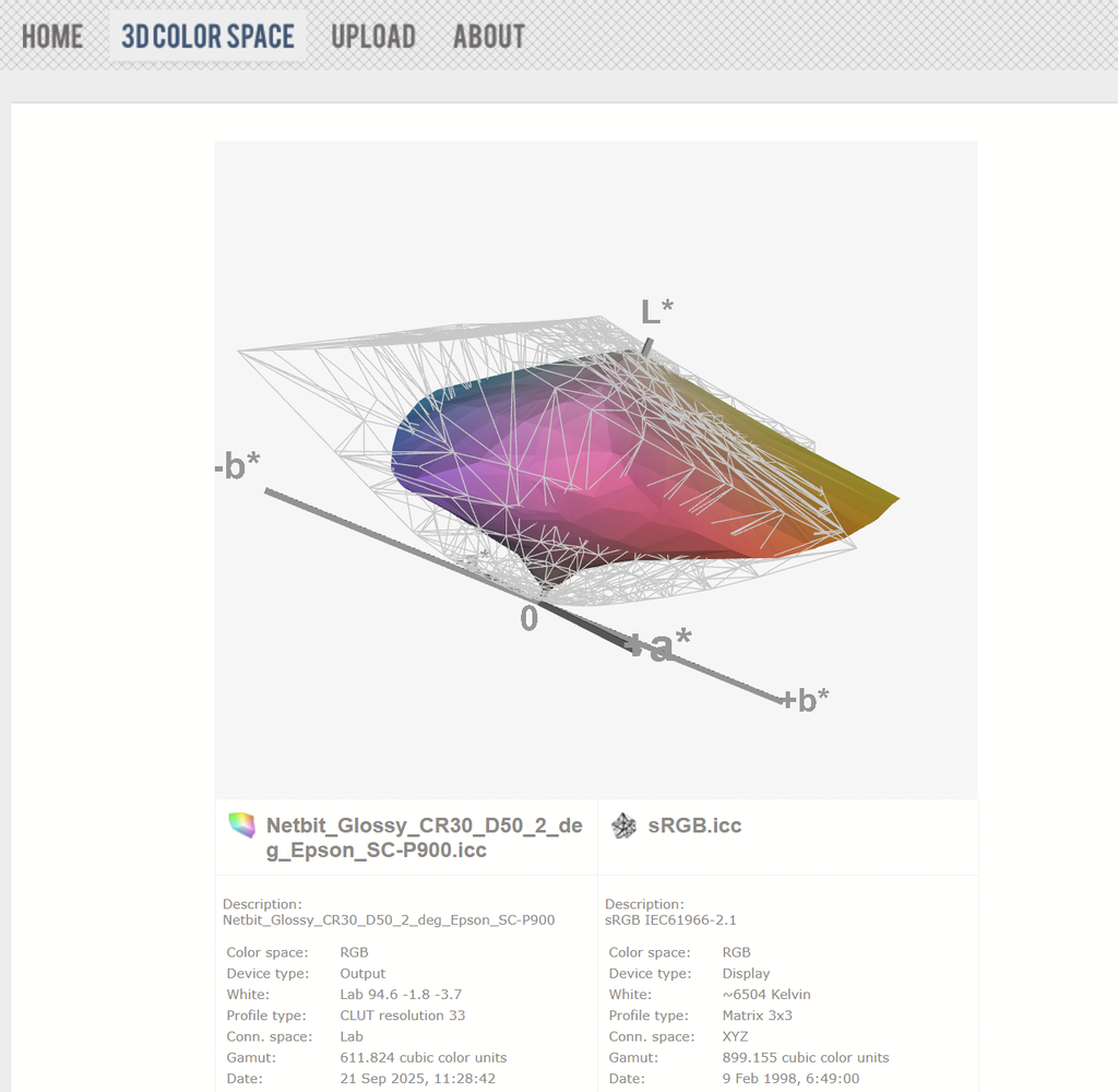

Meanwhile I could generate a profile using my Epson SC-P900 that can produce an exceptional good black point and has a particular mango-shape towards violet (because it has a violet ink increasing the gamut in this area giving a mango-shape pointed bulge in the blue/violet region and the magic is still there:
The CR30 spectro does registrates the very good black point see below:
And here the mango-shape bulge feature of the violet ink that is also well registered by the CR30:
Above target is generated with the 228-patch target. I will try to redo with a slightly larger target to see how it behaves. Note: 228 patches is more than enough for modern printers as those printers are very predictable in behaviour.
I noticed the calibration cap has a serial number matching that which the device reports to the application. Our white calibration values differing shows the device has has a factory calibration for itself and associated calibration cap.
