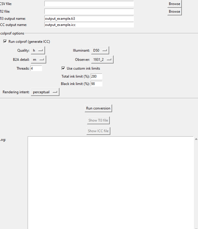

Working on easy GUI for script. Dont need to change ini config file and we can set parm for colorprof.

Working on easy GUI for script. Dont need to change ini config file and we can set parm for colorprof. View attachment 17620
Nice, that looks pretty good, If you fork from the main repo and push a PR I'll take a look and release it. If you are interested in further development (e.g. wrapping more argyll systems, data visualization, further input support/conversions) I can make you a collaborator.

Despite the incredible possibilities of ArgyllCMS it still remains a bit cryptic and an graphical user system that is easier to use than the previous attempts were still a bit cryptic even you can choose the options with a kind of pull-down option. A simpler approach with standard options already chosen like the software of i1Studio with everything in standard industry settings (M0, D50, 1931_2) for a printer profile already chosen for you and a extra "expert" tab for those who want more control, but masked away from a simple primary approach when starting the program, would be nice.
I just trying to make easy to understand gui that use Yours skript. It makes changes automaticly on config ini file and argyllCMS. Nothing special. I also have cr30 on the way and in the future i will try to use it on displaycal. Its just chatgpt helpling me in that. Not my main skill :D I need cheat solution for calibrating display and print profiles for diffrient items using converted epson for sublimation. My main focus is 3d printing CAD and drones :D so yea every faster way of working is a plus

Can U sent ti1 ti2 tiff file and readings from cr30 as one zip? Then I can test faster all features in gui having newest files. And as of measurements: measure from a1 going down and then starting from b1 or b19?

Shoud works now. change from txt to py and paste it on src on x64 script.

Sure i use all my 20 cores :D Now im trying to add making targets to gui
