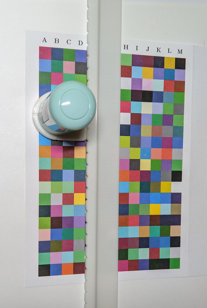

Here is a collar and 300mm rule for 10mm square patches.
Rule and collar on your 247 patch target scaled by forced printing at 518 dpi.
Align the rule to the edge of the patches with notches central. Press the button and slide to the next notch. I can't see how that isn't faster and less error prone than manually locating each larger patch and it is half the ink, half the paper, or twice as many patches.
STL attached. You may need to tweak printer calibration to make the collar a snug fit.

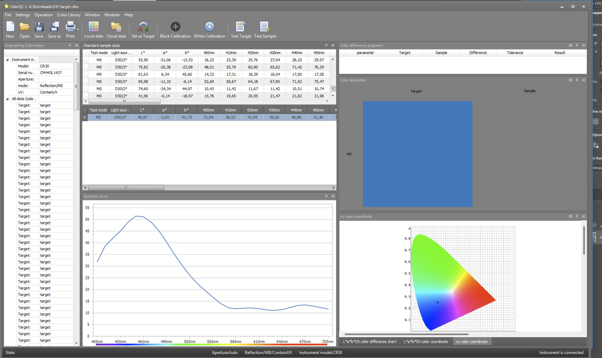

@x64 : You were right the randomisation was the cause of the hanging of the colprof process. I now have changed the patch layout to be non-randomized, but in doing so the grey ramp is sometimes difficult to determine where the next grey patch starts. To visually overcome this I have introduced a tiny separation line between patches so it is now easily visible where the next patch is located.
For those who alreaady downloaded the previous 247-target: please discard the earlier version and download this latest version:
This is the target layout on A4 (to be printed in the borderless setting, NO Expansion, retain size in order to maximize the printing surface without running of the paper):
NOTE: it is very important to start reading from the first patch starting from the patch closest to the letter, so in the below image the white patch on the upper left white patch (A1)....up to the last patch on the bottom right purplish blue patch (M19). It took me about 10 minutes to scan and save the data with the ColorQC2 program. I have activated the registration of the spectral data in the measurement setting from 400-700 nm (setting M0 and D50/2 degrees as the colprof command will use the 1931_2 viewing angle (2 degrees)), so these necessary data is included in the exported .xlsx file. Afterwards use OpenOffice/Excel to export the data again into a .csv file (comma separated file) to be feeded to the python scrip build_profile.py after having modified the profile_config.ini file to your taste and file names used and desired.
