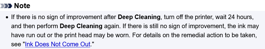

The User Manual for your printer states
Deep cleaning generates heat and stress on the print head. Heat can kill nozzles. and reason to be most judicious with Deep Cleanings.
https://ij.manual.canon/ij/webmanual/PrinterDriver/W/PRO-200 series/1.0/EN/PPG/dg-c_cleaning.html
