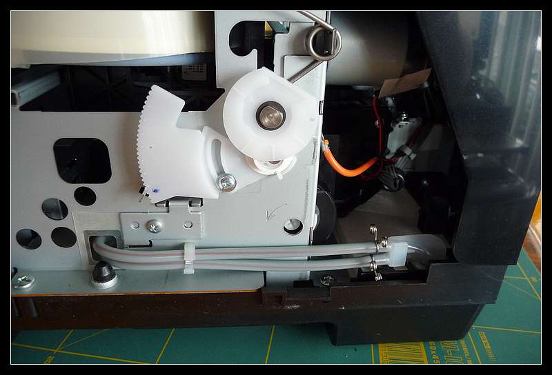

Today I managed to have a look how the waste ink tubing is located in my printer and it was quite easy to reach it.
First you have to remove the back panel by unscrewing it (3 screws), see first and second picture
The waste ink tubing (2 tubes) are located on the right side, where the printhead is parked and this is how it looks like:
I now have to find the necessary tubing to redirect the waste ink tubes into an external bottle and I am not sure how to get it elegantly through some hole in the back panel.

Hi pharmacist
Just looking at the waste tubes, could you not just add a straight joiner to the existing tubes right where the spring clips are
and then feed the new tubes straight through the back panel and place your external tank there out of sight..

@Pharmacist...
If you can take some more pictures of the right* side panel (*when look at front of printer) and around towards the back so I can get a clearer idea of the whole layout I can provide an appropriate solution...
I suspect you're going to have to do a little drilling though...

That's outstanding! It appears to be almost identical to how the R1900 tubes are situated. Accessing is also the same. I drilled two small holes on the side panel and ran two lengths of model airplane fuel line to a 4 oz empty ink bottle. Now on retrospect I should have run it out the back somehow. But it works perfectly and it should work on the R3000 as well. One last hurdle solved.
