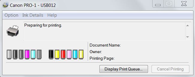

I finally got a set of ARC’s from China for my Pro1 and put them in yesterday.:weee
As expected the printer did a full purge on all the ink tanks before it could print
but it only wasted about 35 ml of ink in total,
which isn’t bad considering this printer has its own CISS system.
I will monitor the ink usage myself over the coming months and check
to make sure that these ARC’s are behaving themselves (Always Showing full). :hide
So it’s Happy Printing from now on and no more annoying pop-ups every 20 minutes..:celebrate

As expected the printer did a full purge on all the ink tanks before it could print but it only wasted about 35 ml of ink in total

All of them! LOL
2.91 ml per color is not that bad since you are refilling anyway!
