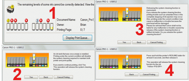

This is just an update and sage on the Pro 1s ink monitoring
Here is the new look ink monitoring on my Pro 1 since I got the unwanted firmware upgrade.
(1) They have added a new blue ? Symbol in the on screen ink levels now.
(2) It detects a new replaced empty cartridge from where there was a full one before.
(3) A new warning about liability and the use of refilled cartridges added.
(4) The usual 5 second button thing and now no cleaning on that colour any more !
As I will be using the all new Chinese ARC chips soon this should get me away
from all these annoying pop ups that keep appearing each time a cartridges has been disabled.
I will soon be able to use the printer far more once the ink monitoring is back working
and fooling the system into thinking that all the cartridges are full and functioning properly..

Re item (4): It looks to me as if the print head has two banks of 6 cartridges each, so I guess you have the possibility to clean right or left bank or both, from the maintenance tab? If so I cannot see how one cartridge can be excluded from cleaning. I think the warning about the yellow cartridge being excluded from cleaning is not true and a part of a scare tactic.
I totally agree that its impossible to segregate out just one colour without affecting the other four;
there are 3 separate banks on this printer.
The reason why I posted these pictures of the new firmware or should I say strong arm ware tactics
is to highlight the extent that Canon are willing to go to stop owners disabling their ink monitoring or using refill inks,
all three warnings mention releasing the cleaning of individual colours..
