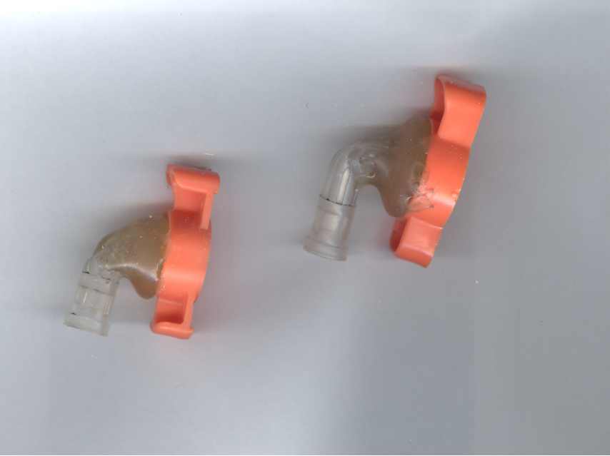

Success at last :D

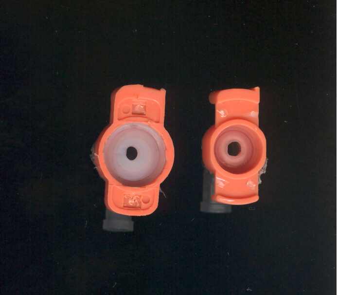

I wanted to copy the adapters made by ghwellsjr but had no luck in finding hoses in the right dimensions. Checking Danish automobile accessories shops online I only found hoses in metric dimensions which were not the right sizes, so I made adapters from the orange bottom caps for Canon cartridges.

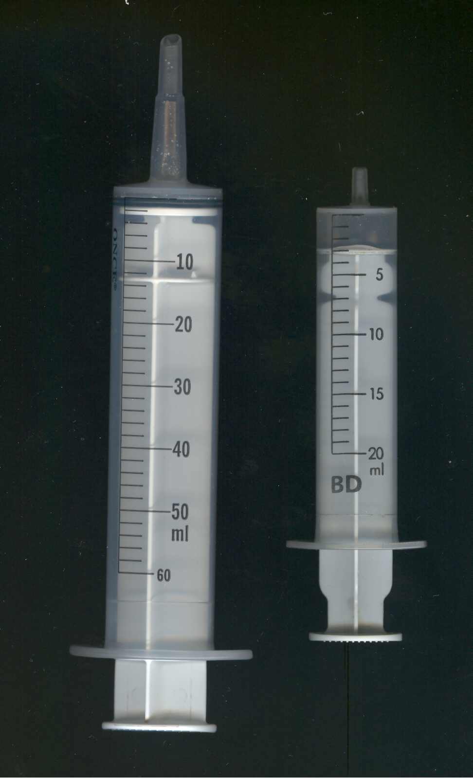

I found a couple of needle covers that fit perfectly on the 50 ml syringe bought at my local pharmacy. I bent them in a 90 angle using a candle for heating. I didn't want to ruin the syringe, this bending takes some practise to find the right amount of heat. I found that a pair of pliers type of leather punch is perfect for cutting holes in the bottom caps and the silicone rubber gaskets. A drill bit is no good at this. I used hot melt glue for glueing the bent plastic pipes to the bottom caps, after having made the surface of the plastic parts rough using a fibre glass pencil.

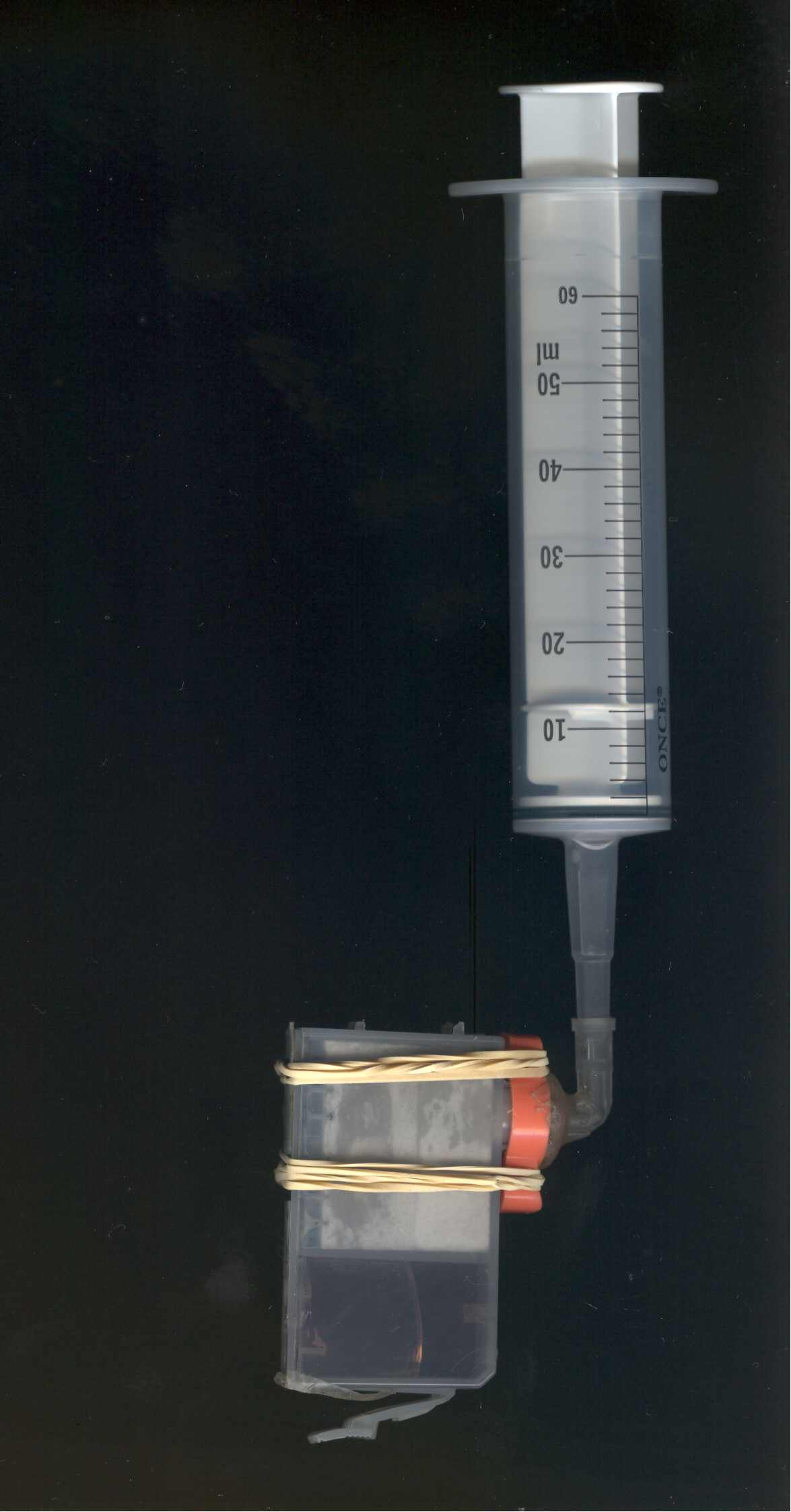

I found that keys to success are the use of a 50 ml syringe with low friction and getting an airtight seal. The 20 ml syringe in the picture has too much friction, so you will be tempted to push the the plunger and risk ink spraying out. Note the 50 ml syringe has an O-ring seal, and the 20 ml syringe has none. It is also important to obtain good airtight seals at the bottom and the vent. I tried different types of tape and the best was a double sided sticky tape intended for posters.
With this setup the method works like a charm for the BCI 3/6 and PGI-5/CLI-8 cartridges. No disconnection to get rid of air is necessary when using the 50 ml syringe.
For the transparent cartridges I think "The Freedom Method" is a winner and I will start using it. Has anybody tried it for the semi-transparent 221 series of carts and the opaque 225 series of carts ?
The PGI-5 cartridge in the setup picture has been filled with distilled water for testing/practise purposes. I strongly advise using water and a flushed cartridge for testing/practising purposes. You will be surprised to see how much ink is left in an "empty" cartridge if anything goes wrong!
Images here, click the thumbs to enlarge:
Bottom view: and the setup here: A suitable and a less suitable syringe:
