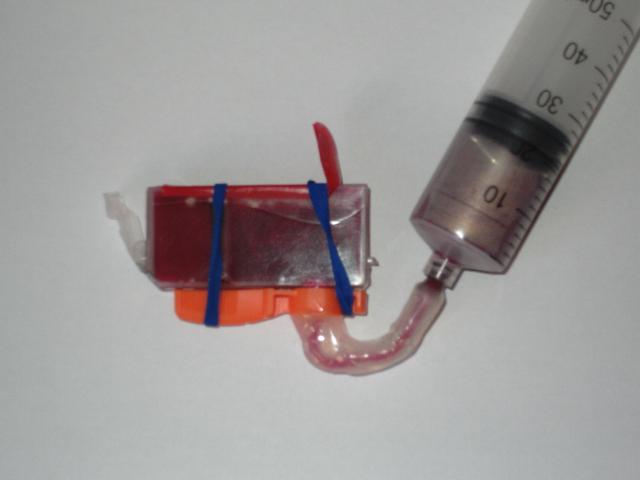

You want to have a short and wide path from the cartridge to the syringe. If it's not short, you'll waste the effective vacuum and wide so that the air bubbles coming from cartridge won't restrict the ink flow from the syringe before you start releasing the plunger. In other words, if you had a long thin tube between the cartridge and the syringe, all that air would get sucked right back into the cartridge before the ink could get there.
The purpose of the right angle bend is to allow you to position the cartridge while you're pulling back on the plunger so that air from the reservoir can escape (the hole in the wall needs to be uppermost) and then while you're letting the plunger back in you rotate the apparatus so that gravity will help the flow of ink into the reservoir. If you had the syringe going straight into the cartridge, the air would escape fine but the ink would have more of a tendency to flow toward the air vent (and the top of the sponge, which I'm trying to prevent).

This is the device i built when I tried the "freedom method" on an inktec cartridge. The inner tubing is 2mm diameter and 5-6 cm long. The luer-lock part of a neddle, tube and cap are superglued together and covered with hot glue.
After I refill there is no air in the ink or sponge area and the ink bridge is fully functional, but I have a problem with ink getting in the vent area. Ink is begining to fill that area on the second release no matter how slow or fast I let go of the plunger. If I apply a lighter vacuum the problem appears later in the process. When the ink compartment is full, the vent area is full too. Because I never push on the plunger, the space above the sponge and about 2mm of the sponge clears when I remove the tape, but I am worried that on the pigment cartridge the maze will be blocked after a few refills.
Maybe on an OEM cartridge I wouldn't have this problem... Or maybe the sealing on the vent shouldnt be too perfect...
Any suggestions?
