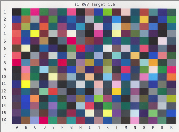

Try printing again using this Adobe application:
http://helpx.adobe.com/content/dam/kb/en/834/cpsid_83497/attachments/ACPU.dmg
and use it to print a TIFF image (you still have to choose no color management after you click print).
Or, better yet, print the colour target I uploaded and see if the black patches are still bluish.

I've printed a test print through the Adobe Color Printer Utility. It came out more dense, bluish greys and nearly no pinks. I can't find your color target uploads. Where did you place them?

There's an attached file, "i1 RGB 1.5.zip" on the bottom of the last post, there's a TIFF inside.

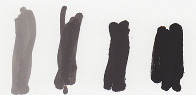

Ups! Didn't see the attachment in the first place. I've printed the target and it came out better than I thought it would. Some colors though are much darker than in the file:
1B, 1E, 1F,1N, 1P, 1Q and 1R alone in the first row. Also 12b, 13B, 14B, 15B are very different among others. I made samples of the four blacks, and they all look neutral. I attach a scan of the print and the black samples.

Apologies for butting in, but I think this is getting more complicated than it needs to be. First, using ACPU to print a normal image is not helpful. ACPU was intended to give a simple "no color management" path for printing profile targets. You don't want to print normal images with no color management - they are guaranteed to look bad.
Second, the i1 profiling target is untagged, as it should be, so I'm really not sure what it is telling you. When you opened the file did you assign a profile to it? Did you print it using ACPU? Did you apply color management in the printer driver? Too many questions, too many variables. But, even if you assign sRGB and print through a normal color-managed path, more than half the colors in that file are out of gamut for a 3800 so I wouldn't expect the print to be a brilliant match to the screen.
For me, everything suggests that the IR blacks are more neutral than the OEM blacks, which are a bit warm. The Epson profile will add a bit of cyan across the board to compensate this warmth but will give a cyan cast to the IR print. Maybe the IR cyan is a bit more saturated than the OEM - hard to say without real measurements. But, whatever the combinations I think you just need a custom profile if you want accurate colors - most third-party ink users find that to be the case.
