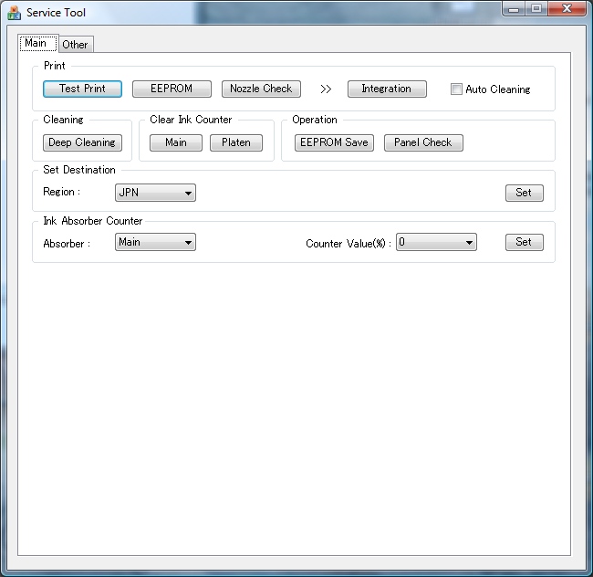

Now now run the unpacked ServiceTool_V2000.exe file. No installation necessary.
You now see this window with two tabs. Click thumbs to enlarge
and
I've tried only the "Test Print" and "EEPROM" buttons on the "Main" tab. You can change several settings with the program, but unless absolutely necessary don't try other operations , especially if you don't have the service manual. You might delete info or change vital settings. I've made such mistakes my self, therefore this warning. Link here: http://www.nifty-stuff.com/forum/viewtopic.php?pid=49752#p49752

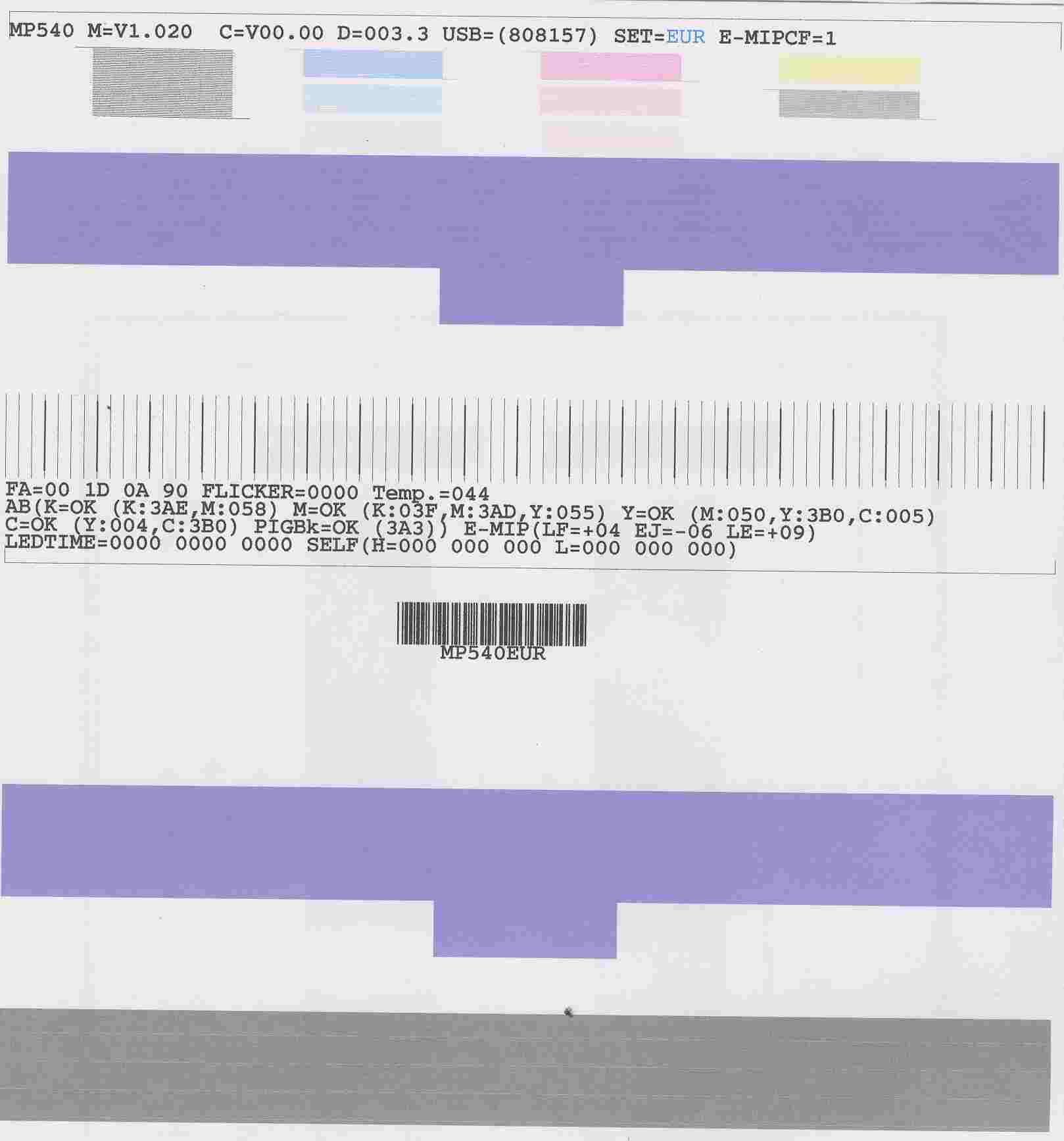

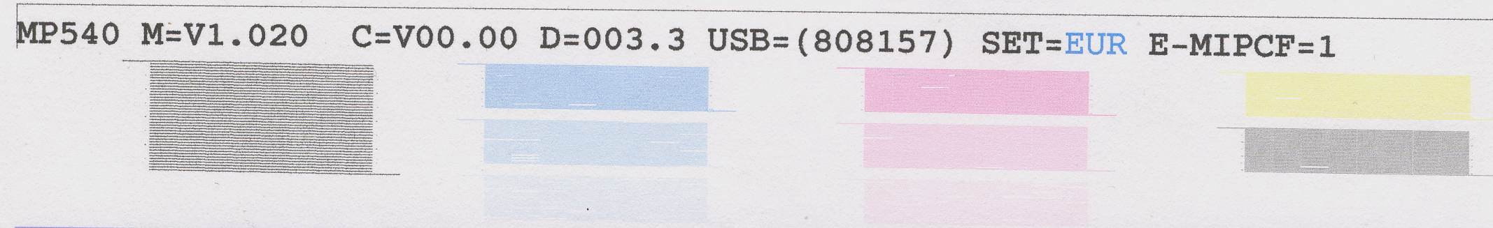

Click the "test print" on main tab and the the text is greyed out. Now wait for the familiar style test print with extended nozzle check etc. Don't panic even if it seems to take forever.. You will eventually get the printout and this pop-up window: Click the thumbs to enlarge, and click the enlarged cropped image again to expand to full size.
and cropped for less JPG-compression: and the pop-up:
It is seen from the cropped image, that this printer has a problem with the printhead.

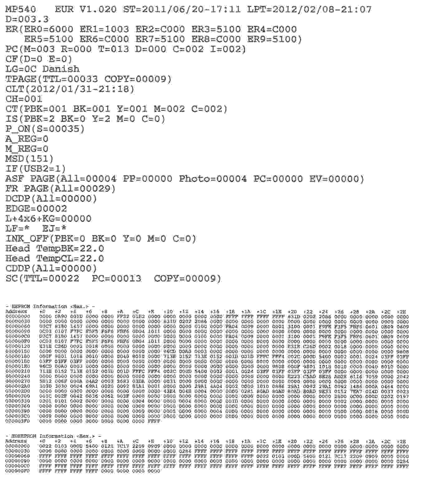

You may now proceed with service mode operations. Click the "EEPROM" button on the main tab. This produces the EEPROM info printout, you also get the option to choose paper source for this printout. This operation also takes long time to finish. Click the thumbs to enlarge:
and the pop-ups and
Exit service mode by turning the printer off using the printer's Power On/Off button, and close the Service tool application.
