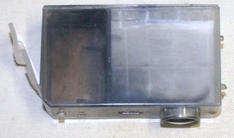

I recently found a very easy way to purge Canon OEM dye ink cartridges:
If they are dried out, you need to turn them over and dribble some water into the outlet port to get them wet, just like they would be if they had some wet ink in them.
Fold a paper towel in half four times so that it is 1/16th its original size.
Fold over about 1/4 inch of the last corner that was folded.
Place this thick piece of paper towel into the outlet port.
Wrap the remainder of the paper towel on both sides of the cartridge.
Hold the paper towel in place with a rubber band wrapped many times so that the thickened piece of the paper towel is in good contact with the filter material in the outlet port.
Set it aside for a few hours or overnight.
Here are some pictures to show this process.
Most, if not all of the ink will soak out of the cartridge and into the paper towel. Some cartridges come out pure white and totally clean in one try but it will probably take one repetition to get it completely clean and dry.
If you are concerned about the small amount of ink in the reservoir, you can fill it with water using the German method.

I think your way is an EXCELLENT way to DRY the cart. I did a test yesterday evening after reading your comment, I even left some water ( one third ) in the ink chamber so I could see the level of ink change if the paper towel would suck ink out of the outlet.
WOW, I only turned by back, and the ink chamber was already empty !
Then I took the weight of the cart ( 19 gram ) and put a new towel on the cart for the night. This morning it was only 15 grams....
Here are the pics...Txs ghwellsjr !

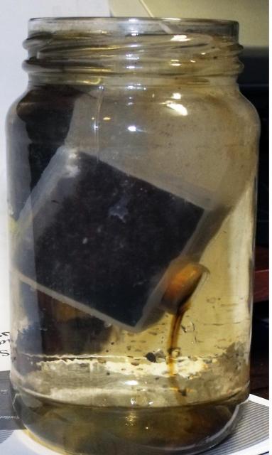

When I clean out my pigment cartridges I leave them for a couple of day in a jam jar to drain out the rest of the old ink completely. I check them every few hours and if the water is very murky I empty it out and refill, repeating this several times till water stays clean. See pics ..
