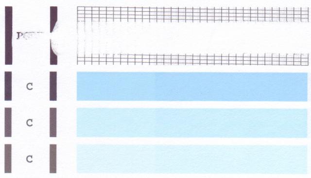

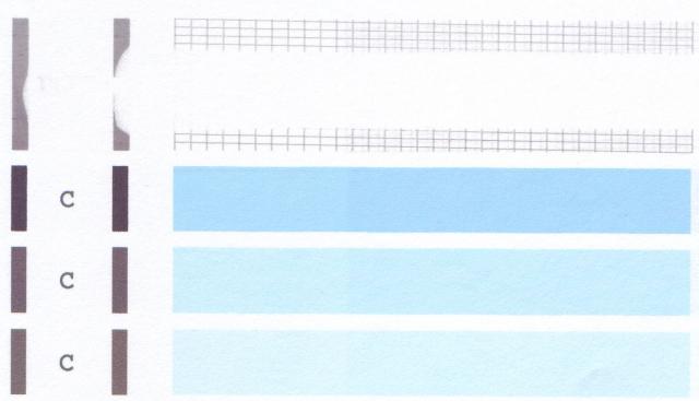

*UPDATE 2*
Just a quick update on the progress of unclogging the PIGMENT black.
Here are some scans:
Scan #1 After the first Cleaning cycle
Scan #2 After the 12th Cleaning cycle (this included 3 deep cleans along the way)
Progress is slow, but there are improvements. The grid pattern got progressively darker and more of the grid got printed. You can just make out the letters "PG" in the second scan.
To get to this stage I basically went through ALL my previous steps - including a head soak. I know I said I would omit this step, but I later thought I might as well do it properly. I did not soak the head overnight as before but left it there for a few hours.
I also changed the soaking solution and increased the strength by adding isopropyl alcohol and household ammonia to W5. I basically tried to follow pharmacist's cleaning formula as close I could with the materials I had to hand. But I did not have propylene glycol or glycerol. I am not sure how crucial they are to the mixture. Probably very important.
Between each cleaning cycle I put 2 drops of the cleaning solution onto the inlet screen of the PIGMENT black only. I put 2 drops of the solution on the large dark purge pad making sure the pad was not overfilling. I also added about 5 drops onto the outlet of the cart.
I wanted to do more deep cleans but didn't want to go against Canon's advice on no more than 3 deep cleans in a 24hr period.
I finished off with 2 drops of solution on the inlet screen of the pigment black and turned the printer OFF. I will check it after 24hrs to see if there are any improvements.
Thanks.
