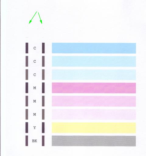

I have an Canon IP4500 and after doing a Nozzle Check test print I noticed that the PGBK "grid" pattern did not come out at all. The rest of the print patterns were fine. Does this mean I have a clog in the print head for the PGBK cartridge? I decided to do some quick tests. This is what I found

I have uploaded a scan of the nozzlecheck on plain paper:
As you can see the PGBK row is almost non existent. There are a few specks of ink indicated by the arrows. I will answer the questions in turn:

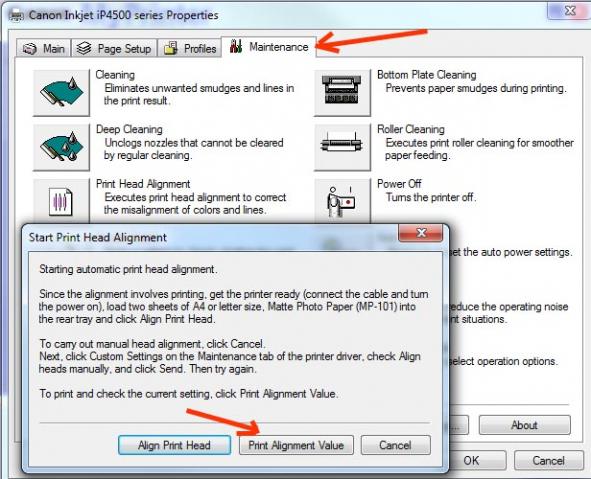

- I have done the auto alignment but that did not improve matters. BTW how would I get "values" from doing this? Is there a log file somewhere?

I wouldnt print any head alignments or anything else till you get the PGBK black sorted out first.
Your black print head is completely bunged up from lack of use so will need to be cleaned.
Your best option is to remove your print head from your printer and soak it over night in some Windex.
Submerge it about 1" deep in the solution and leave it to soak.
Next day dry it off with a paper towel and leave it somewhere warm to dry.
Made sure it is completely dry before putting it back in the printer.
Put a couple of drops of Windex on each of the inlets where the cartridges sit and do that two or three time over half an hour.
Then put in your cartridges while there is Windex on the inlets and do a head clean followed by a nozzle check.
If the quality still isnt good remove the black or colour cartridges again and repeat the Windex
on each of the inlets then do a deep head clean followed by a nozzle check.
You may need to do a few head cleans on the black to get a good clear nozzle check over the next hour
or so leaving the printer to stand for a while between head cleans..

You may have a clog in your pigment black ink purge system, in which case you will never be able to get any cleanings to work so check it out first. In tests that I have done, it appears that Hobbicolors pigment black ink may have the same problem that my older Inktec pigment black ink had in that it would clog the purge system.

As was pointed out, you shouldn't print anything except nozzle checks. An alignment is of no value unless your nozzles are working anyway.
