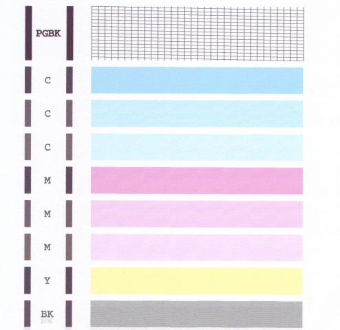

The problem with this printer is a clog in the purge system, not in the print head. If the purge system is not working then it will look like the nozzles are clogged when you really can't tell. That's why I always recommend when all the nozzles of a certain color are not working to check the purge system. That's what I did on post #7, my first post on this thread.

*UPDATE 4* - SUCCESS! :)
Just to give an update on the progress and I have finally unclogged the printer head and all seems to be working fine now.
Looking back it was not only a head clog but also a partially clogged purge unit that caused all the problems. After trying to unclog the head for several days, the nozzle checks were getting progressively better but the grid patterned was still not printing 100%. Parts of the pattern were missing. Then my attention focused on the purge unit. I started to fill the purge tray with solution and waiting for about 3 days (topping up where necessary) without printing. Then I decided to do one last nozzle check and hey presto everything just worked - I got the perfect nozzle check! It was a relief since I did not fancy opening up the case.
A big thank you to all that contributed - it was a great help!

Does the liquid that you place on the purge pad get sucked away when you do a cleaning? If not, you still have a purge system problem that will not go away all by itself. Sometimes you can get the nozzles to work by soaking as you did, but the problem will come back as ink accumulates on the pad if it won't get sucked away. Maybe you can periodically clean the pruge pad to prolong the life of your printer.
If it does get sucked away, I would recommend that you use a lot of Windex in hopes of getting the waste ink pads to start flowing again and please don't use Hobbicolors pigment black ink.

Yes the solution does get drained away but I am not sure if there should be a little solution left on the pad. I will keep an eye on it.
