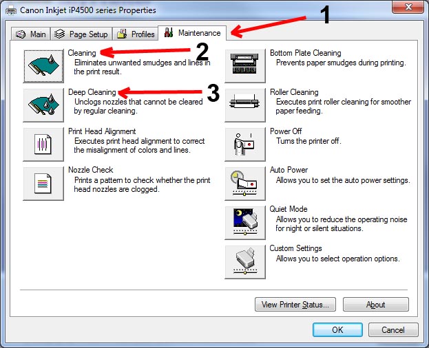

1) Start off with a clear warning not to print anything except nozzles checks until all nozzles are unclogged since extensive printing with no ink flowing can overheat and burn out the heating elements.
I don't disagree, but I would hope you would be willing to write-up a better "HowTo" and see if Rob L. would make it a "Sticky". I consider my attempt as just a draft to hopefully bring about further discussion. And also, I would rate myself as having little or no legitimate creditability on de-clogging, as I don't have all that much experience at it.
2) On your second and third bullets you use the phrase "print driver" which should be "print head".
That was intended. I wanted to be specific and unambiguous that this is a regular cleaning and then a deep cleaning from within the print-driver. I only have experience with Win-7 controlling my Pro 9000-2 and ip4500, which don't have any LCD screen, and have essentially no user interface. Other printers, especially all-in-ones may have an LCD and can be stand-alone without being connected to a computer. Also, our nomenclature may be inconsistent.
3) I would suggest that people only do normal print head cleanings unless they are using a specially prepared cleaning cartriges. They should be made aware that just a few deep print head cleanings can use up all the ink in a cartridge.

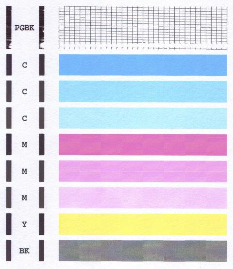

Would it be wise to resolve the clogged head before purging/refilling with dye black? The reason I ask is I am finally getting somewhere with the unclogging and the nozzle check is printing something now. See pic. The contrast has been increased to make it clearer.
Maybe I am being impatient since I am an unclogging newbie :lol:

tsu3000 Would it be wise to resolve the clogged head before purging/refilling with dye black?
The sooner you do the refill the better as the dye ink can only help to clear up the rest of the head (Beautiful picture)
Now youve got that far and while you have the black cartridge out to clean it, put a drop of Windex on the inlet nozzle
of the black till you ready to pop the new cleaned cartridge back in again.

Here are some additions from the Canon webpage for the iP4500: when searching for "nozzle check":
If the output is incorrect, perform the following steps:
1.Perform a print head cleaning.
2.Print the nozzle check pattern again.
3.If any lines or colors are missing from the nozzle check pattern perform another print head cleaning.
4.Print the nozzle check pattern again.
5.If any lines or colors are missing from the nozzle check pattern perform a deep print head cleaning.
Caution: Avoid performing more than three deep cleanings in a twenty-four hour period.
6.Print the nozzle check pattern again
7.If the Nozzle Check Pattern output is still abnormal even after Deep Cleaning, turn off the printer and letting it sit for 24 hours or more, then perform Deep Cleaning again. The wait time may allow dried ink in clogged print head nozzles to liquefy, and resolve the problem.
If the nozzle check pattern is still incorrect, service may be required.
