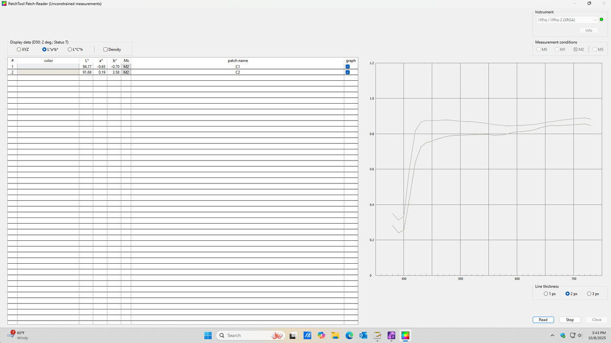

The first thing that seemed interesting was to compare the CM30 and the eye-one using paper with more and less optical brightening agents. Using my Harbor Freight UV flashlight and a Red River sample pack, I found two likely candidates, UltraPro Gloss (very white) and Premium Gloss C2S (ever so slightly yellow). This image is from the eye-one and since it's UV filtered the difference between the papers isn't huge, though far from zero.

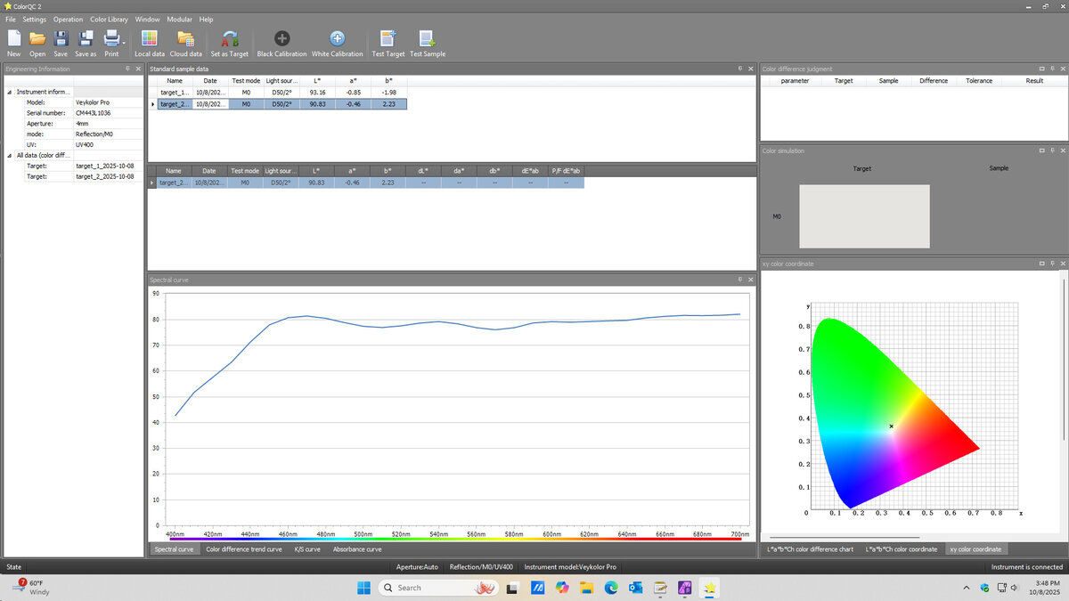

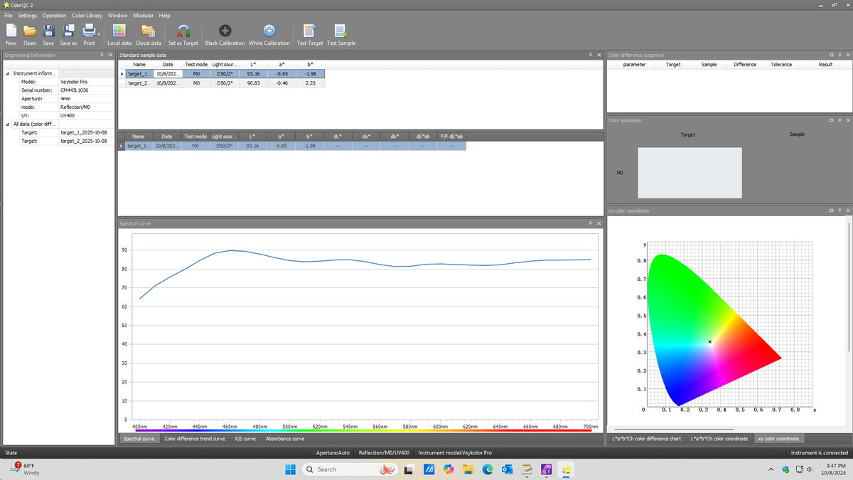

The CM30 software only shows one graph at a time, so here are two images.
You can see the drop at the short wavelength end is substantial with less optical brighteners.

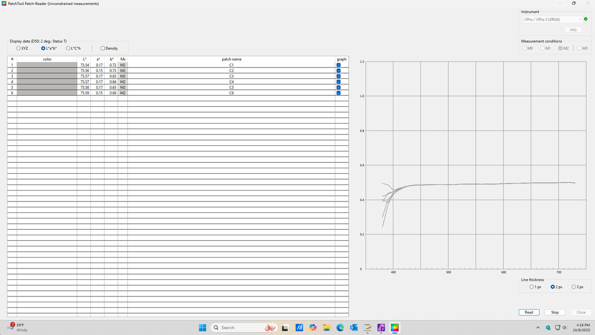

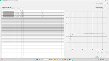

That tells me that to compare the two spectrophotometers I need to use a spectrally flat target, like the Labsphere ones, with no brighteners. (That's not got much Spam in it. What do you mean, you don't want any Spam!) I used the 50% reflectivity one, which I think should have an L of 76.

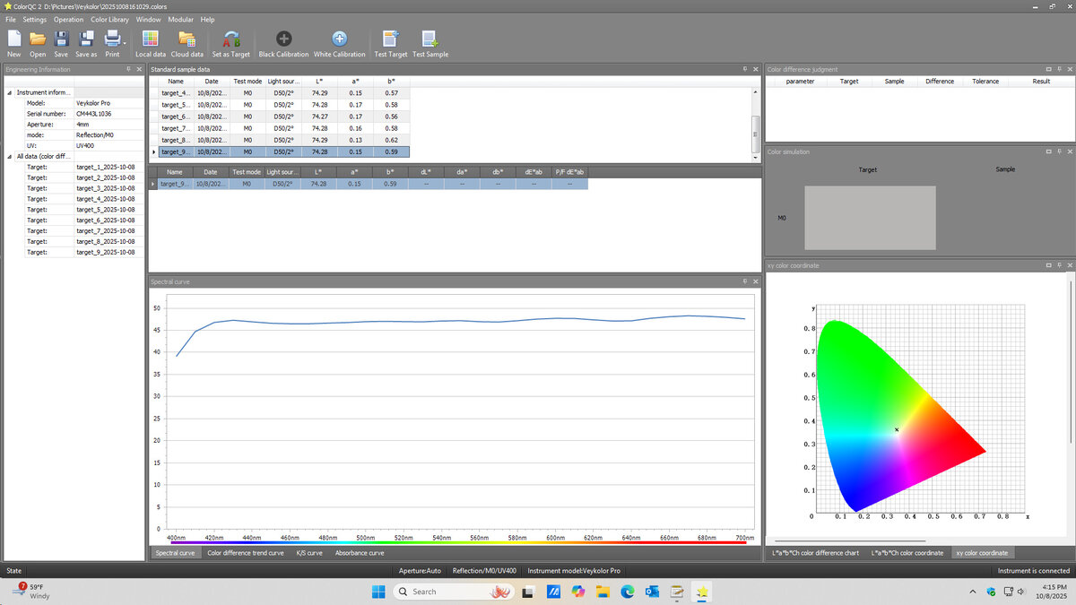

I don't know why the eye-one varies as much as it does at the 400 end. Here's the CM30.
To save your eyesight, the Lab values are 75.57, 0.17 and 0.66 for the eye-one. Then 74.28, 0.15 and 0.59 for the CM30. Both were set to D50/2deg. I think that's a delta E of less than 1.

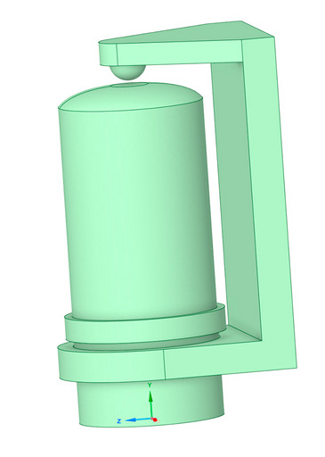

I envisage a jig like this
The CR30 is a loose fit in the jig main part. The collar around the CR30 is fixed. The jig lifts the CR30 by the collar, moves it to the next patch, lowers it to the target then drops some more to briefly press the CR30 button with the top of the jig.
A g-code program to do that for all patches in a target would not be hard to generate from a ti2 file and patch size. Just run that and let ColorQC 2 collect the measurements.
I have an obsolete cheap ender 3 clone I would repurpose if I had a lot of profiles to create.
