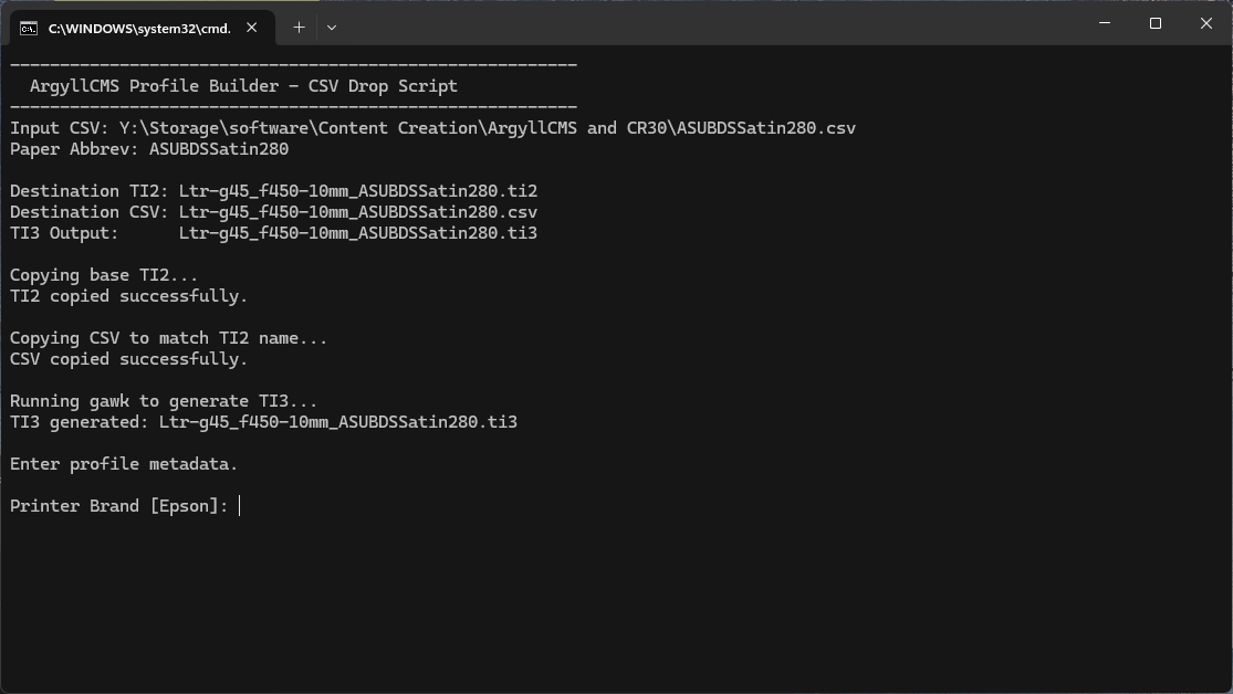

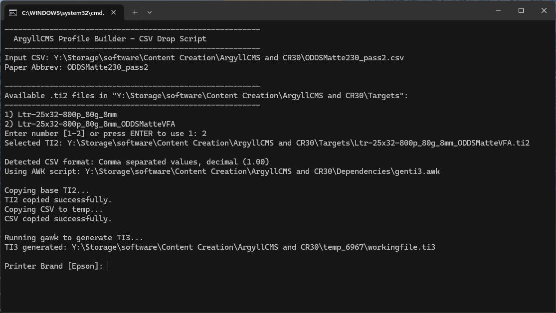

I've made a few changes. You still set the defaults for the files, including the default ti2, but if you keep multiple targets in one folder, it'll read out a list to pick from.
This will be useful for running a second pass against a target generated from a previous ICC profile.
I've also done a little bit of digging, and reduced the paper type selection.

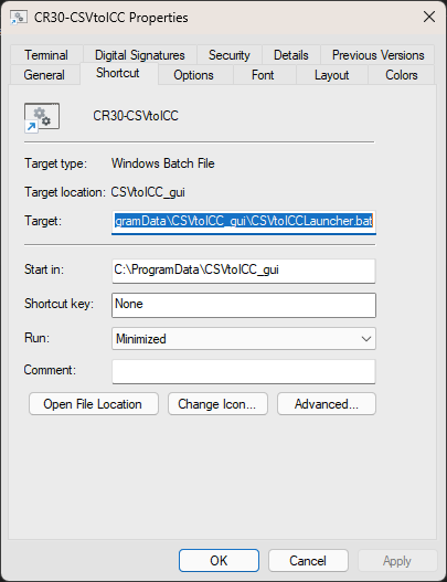

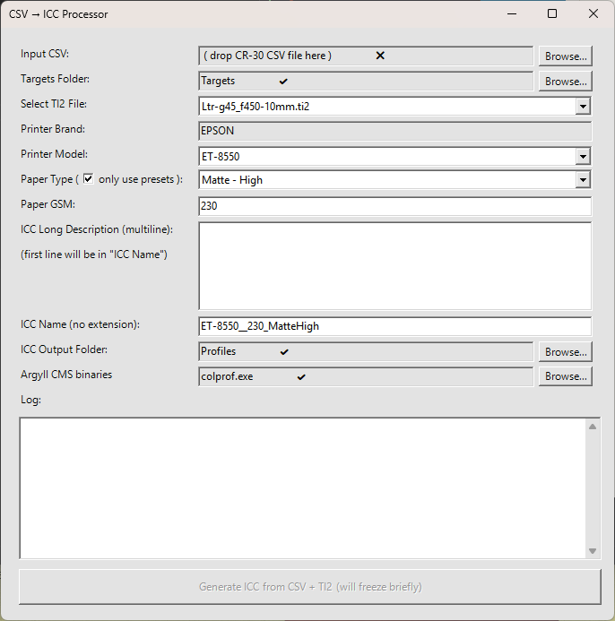

I turned the whole process into a PowerShell forms gui. There's a bat launcher that detects PS5 and PS7 (PowerShell Core), and launches the correct way, including bypassing Microsoft's ever stricter execution policies.
You can make it run just like a normal looking app by:
1. putting the PS1 and bat file wherever you prefer (I put them in C:\ProgramData\CSVtoICC_gui), then
2. creating a shortcut on the desktop
3. right click the shortcut, and click Properties
4. set Run to Minimized
From there, the shortcut will open the app window, and the console will be minimized if you want to see console output (handy if some bug pops up)
When it first opens, you'll have a bunch of Xes where things must be set:
1. Input CSV (needs to be set every time you open the app)
2. Targets
3. Output folder
4. Argyll CMS bin folder
And there are metadata optional settings
1. Printer Model (will set printer brand, and will populate the dropdown list)
2. Paper gsm
Most settings will be saved to %appdata%\CSV_ICC_UI\settings.ini so you don't have to set them again.
The picture above is how it looked after I'd already set everything and re-opened.
The app _should_ be able to read CSV locale independent, but I may need locale-specific CSVs to improve detection and formatting.
PowerShell hates double precision, and tries to reduce precision as far as turning numbers to integers, which ArgyllCMS doesn't like, so any double-precision number is locked at 5 decimal places to preserve precision.
I tried to turn this into an EXE using PS2EXE, but it turned out to be pretty complex, and I could never even get the GUI form to load.
  • CSVtoICC_gui.zip

Oh, couple of other things, if you uncheck the box that says "only use presets" next to Paper Type, it'll show you the machine-level paper types associated with the printer, but they're VERY rudimentary, and probably not very useful. The neat part is it'll let you select your actual installed printer, resolve the paper types and list them out, but I found the actual paper types are so far from the printer preference machinations that I didn't even save the preset checkbox--it's really just to help you create the metadata and filename.
Lastly, while only the first line of ICC Long Description helps create the ICC name, all of the multiline goes into the metadata for the profile.
Had I known PS2EXE was going to be so persnickety, I probably would have opted to start a Javascript/Chromium based app (NodeJS/React/Electron) instead, but that would have taken considerably longer to make a buildable EXE pipeline just to start making an app.
I’m pretty rudimentary in my PowerShell, especially with PS Winforms, so the tradeoff would have been a lot more setup that yielded a lot more flexibility and shorter design turnarounds.

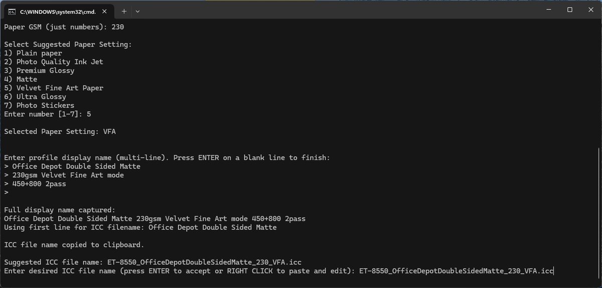

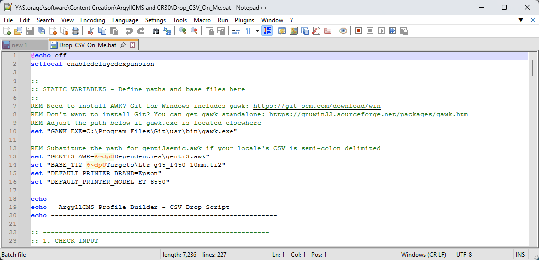

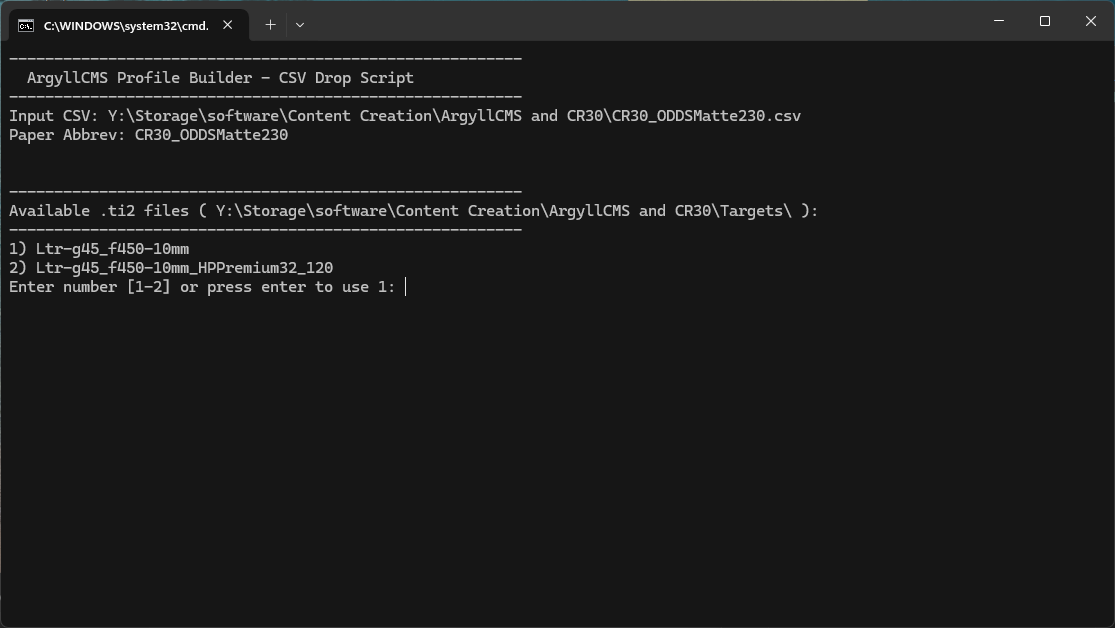

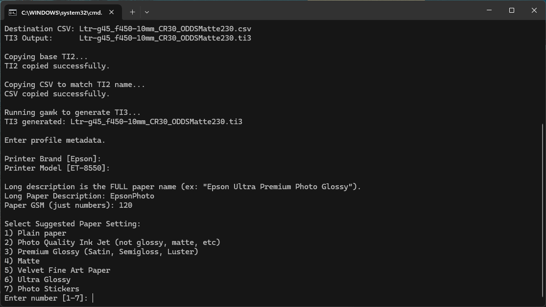

Since I had made a lot of improvements in my pipeline before finding out that the PS script was going to bail on me, I back-ported a little convenience to the batch script:
* Set the path to your Targets and Dependencies folders instead of the specific files
* The batch script can detect comma and semicolon separated values and run the right awk script
* You can type multiple lines for the -D (Display Name) for the ICC profile, and it'll craft the name based on the first line (just press enter on an empty line to stop adding to the display name)
* The generated filename copies to the clipboard so you can paste it in if you want to edit it, or just press enter to accept the generated name
* It'll make a little temp folder in the working directory and ask you to delete it if you get a good ICC profile
CSV format detection between comma+period and semicolon+comma
Right click paste to edit name
  • Drop_CSV_On_Me.zip
