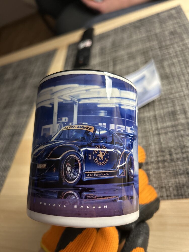

Yes i know that but for now i can’t get to find why. I edit internal file for now using Notepad++ that reads hidden text and u can find “profile” name on there. Will dig more in to that in the future. As of my sublimation. I printed 522 patch on 2xa4 and now prints looks nice
