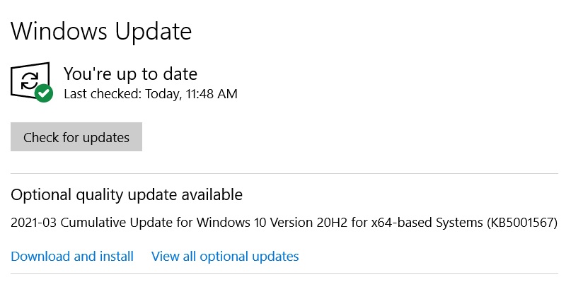

I installed the KB5001567 update. It didn't solve the printing problems. I then wanted to delete the KB5000802
update that had caused the problem but now this update was no longer on the list of updates that could be removed. I don't know if the KB5000802 update could be removed before I installed the KB5001567 update.
Instead I used system restore to go back to before I installed the KB5000802 problem update. Now printing is OK again, but for how long? Is it possible to block automatic install of the KB5000802 problem update?

Maybe, maybe not.
At the end of PeterBJ's post is...
Here is a screenshot of what I saw in Windows Update this morning:
T don't know if this update will resolve the issues in this thread, or if it is a permanent fix. The timing of this update and the statement about it for BSOD when printing may just be coincidental to your issues. Then again, it may be for your issues.
Keeping my fingers crossed, but it is Microsoft! My screenshot of Windows Update this morning is the same as yours. I think I'll do nothing for now and hope for the best.
