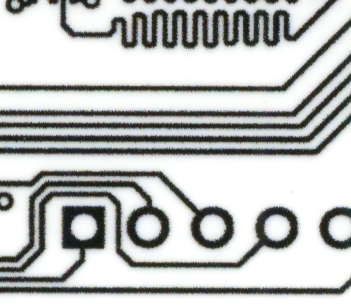

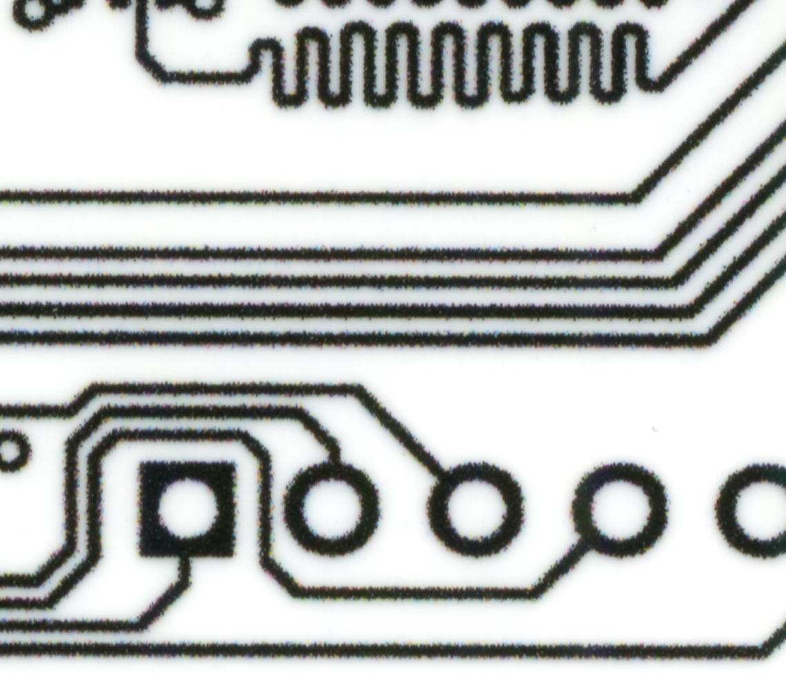

I've done more testing and switched to using Adobe acrobat and makes no difference.
So it seems I get those micro-spikes only if I use the option in the Epson driver to enable "Photo RPM (Max DPI)". If I turn off this feature, the micro-spikes disappear; however, the print resolution becomes low, and the print quality is drastically reduced, almost to the point of being unusable, with trace lines appearing jagged.
I've included the scanned print. To better inspect it, open the image in a new window (right-click and select "Open image in new tab") and zoom in.
I've also included a quick zoomed-in snap-shot:
So, from my conclusion, the micro-spikes occur only when the Epson Artisan 835 is told to print at Max DPI.
I think the printer's nozzles are misaligned or possibly one or more of its micro-piezoelectric ink pumps in the print head is not functioning properly and is dispersing more ink out from the micro-nozzle than it should.
Not sure how Epson print head and resolution functionality work in conjunction, but from an educated guess, it possibly uses all of its black ink nozzle channels to provide ultra-high resolution print when settings are set to use Max DPI and Black ink only mode, thus some of its nozzles are dysfunctional and emit micro-spikes.
If this theory holds true, what I'll do next is to use only one specific ink channel and not use the black ink channel at all, such as using only the Cyan, Magenta, and Yellow channels. I will test each of these ink channels separately and individually and see the results. If I get micro-spikes for each and every separate ink channel, this means it is an obvious driver, software, ink-type issue and not a mechanical/hardware issue.
Not sure how I'll be able to tell the printer to not use the black ink channel and only use the cyan/magenta/yellow channel... I'm sure it's possible.
By the way, if anyone is curious, I'm using a CISS on the Epson Artisan 835 printer with generic ink. I think it does really well. I bought the printer from Facebook marketplace for $25 and it came with the CISS.
However, I'm not sure if it could also be the cause of the micro-spikes during Max DPI prints. I kind of doubt it, because the Max DPI mode provides excellent prints, but with micro-spikes in a patterned form.

Good news. My theory holds true.
The black ink micro-piezoelectric pump channels in the print head are dysfunctional. It is a mechanical/hardware issue within the print head, specifically with the black ink channel, as I suspected.
I've imported the original PCB PDF file into Inkscape. I then changed the vector art color to Cyan, which has the hex code #00FFFF. This, in theory, should tell the printer to only utilize the Cyan ink channel.
I then saved the vector art as a PDF in Inkscape using the following parameters:
  • Rasterize filter effect turned off.
  • DPI set to 500.
I then opened the saved PDF file in Acrobat Reader and used the following parameters:
Below are the glorious results, which are excellent by my standards—clean and sharp print with no artifacts. I can now move on to the next step in UV lithography. All I need to do now is obtain high-quality UV-blocking ink and flush it into the refillable color ink tanks. Any recommendations would be much obliged for professional-grade UV-blocking ink brands and models.
To better inspect it, open the image in a new window (right-click and select "Open image in new tab") and zoom in:
I've also included a quick zoomed-in snapshot:
My next tests would be to try and see if I can combine the Cyan/Magenta/Yellow ink channels to print at the same location, to provide a greater level of opacity. I would need to trick the printer to perform this, but I think I can figure something out using Inkscape. After all, I'll be using an all-black-ink system.
