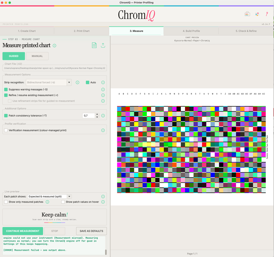

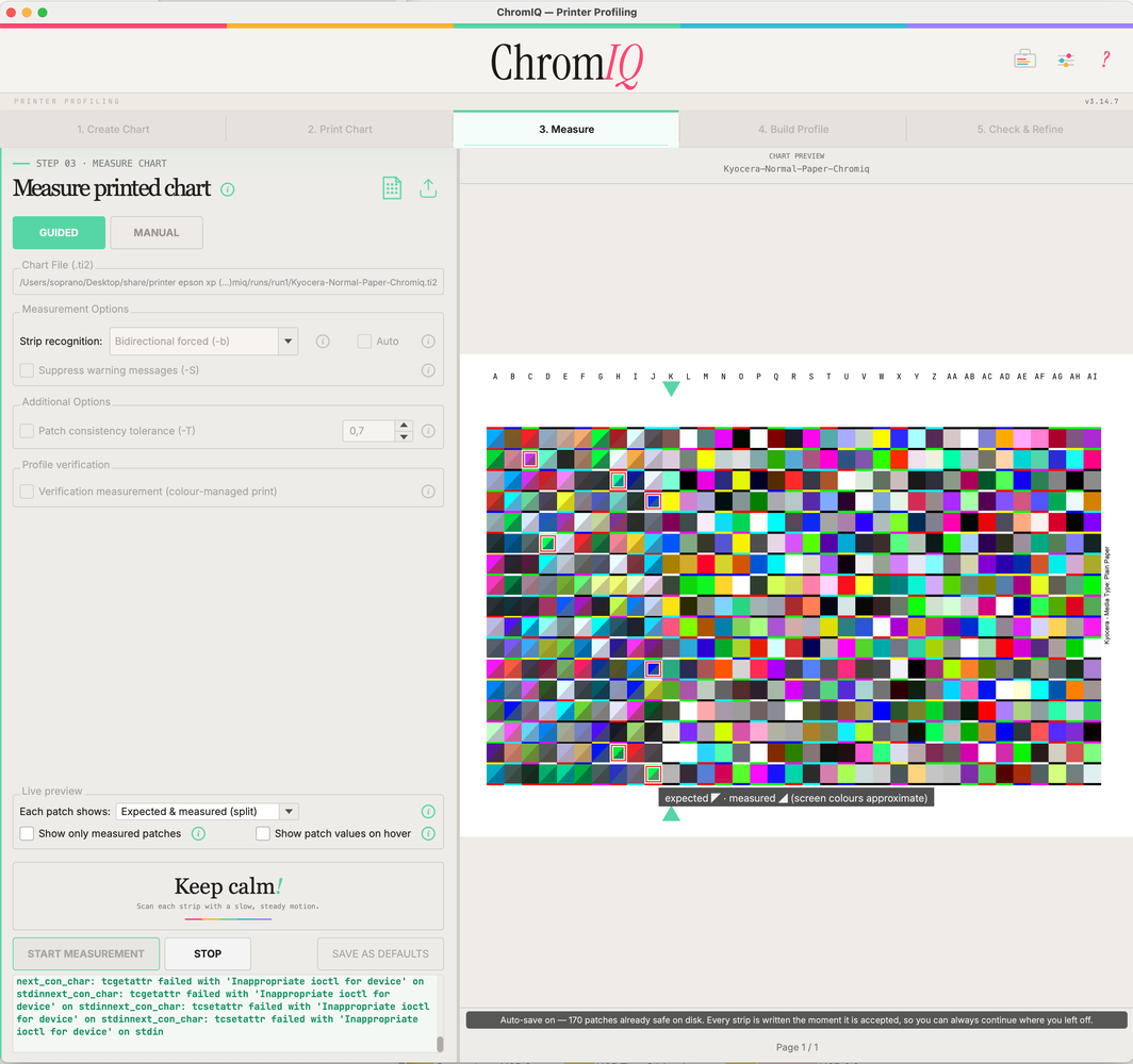

The instrument this morning seems wanting working, so i was reading the patch of the same paper Kyocera Laser printer (plain paper) i had read the last time using Argyll chartread, this one using chromiq chartread just to compare the results to try to understand if the device is reading properly.
After some rows reading it stopped to scan giving this error i will attach the screen and the logs of today tests
I tried to restart the calibration but i don't see the aspected/detected anymore
i'm continuing to scan the patch in this moment

i finished the reading of patches, for @itsab1989 i didn't exit from the measure chart screen, never, but when the device gave the error i had to press stop and the software automatically switched to Argyll chartread removing all the old aspected/detected patch colors, i pressed stop again and then pressed continue and it started with chromiq chartread and the new reading appaired on the screen up to i finished the reading, but the old one seems lost.
I ask you is possible to ask a confirmation to use Argyll chartread, so if i choose no, the old values doesn't disappear from the screen ?

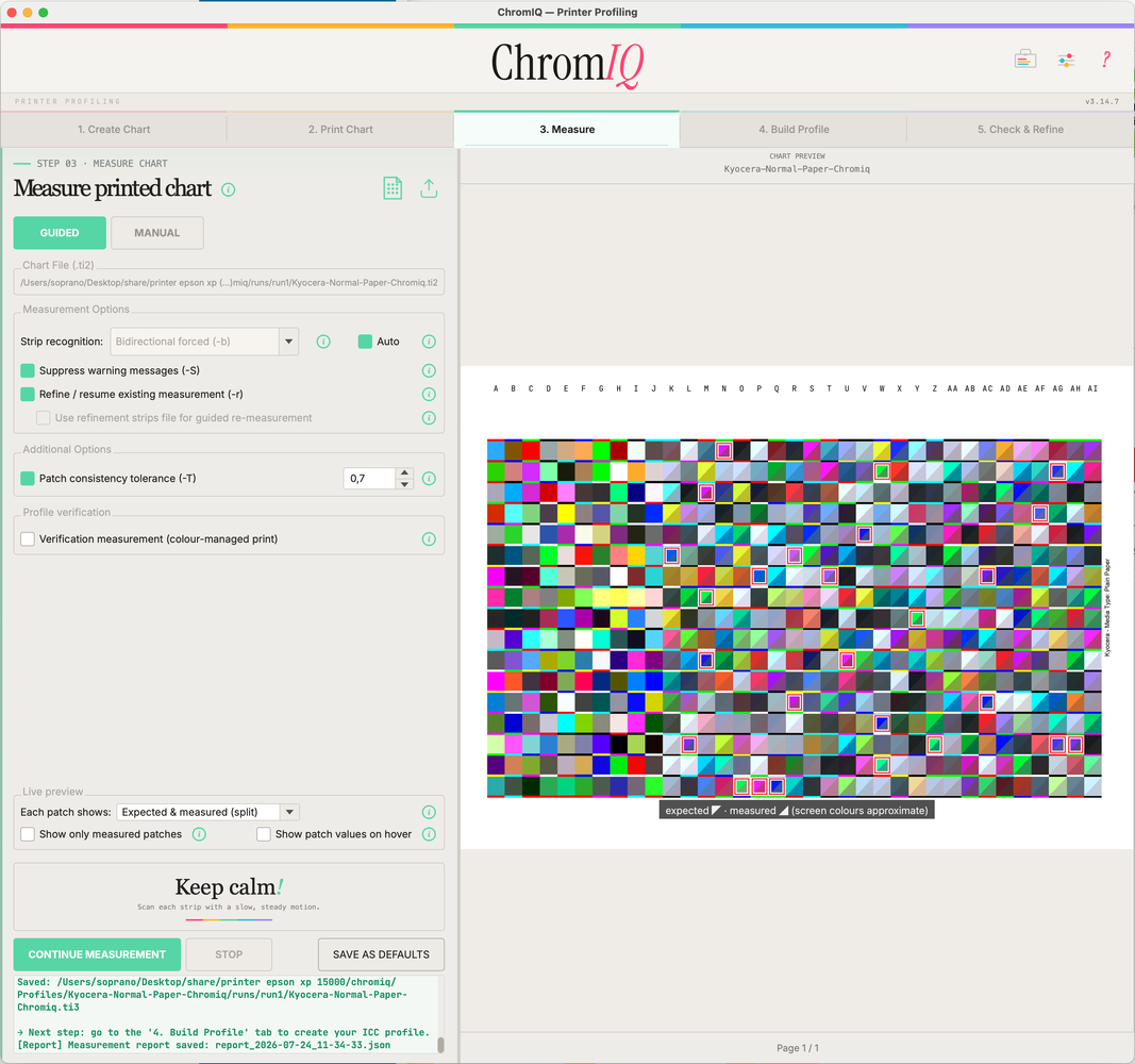

this is the screen of the last scanned patches
it seems that the printer has problems with green, dark blue, pink but maybe is normal i will try to build the profile and compare with the previolus one
this scanning with chromiq has better results versus the first scanning (but maybe i was less accurate in the scanning process)

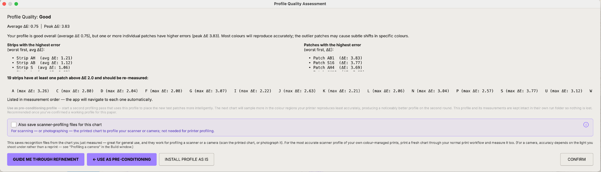

I tried to reread 7 of the 19 strips, but visually no differences from previous reading and rebuilding the profile, it passed to delta e=0,74 from 0,75 and tells 18 strips instead of 19, so i suppose the reading is correct or the instrument is reporting about the same values.
so i supect the reading are right
anyway @itsab1989 it will be perfect if it shows all the previous reading when i do a refinement (while it shows the patches without any aspected/detected color) and it should indicate also which strips need refinements (with an X for example) so one knows which one to scan again (obviously these are requests if possible)

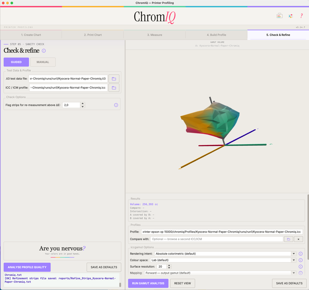

- in the gamut analisys is possible to rotate the shape, but when i compare two profiles if i rotate one of the shape and switch on the other one it will show from the starting position, if i come back to the other one (that i had rotated) it shows again in the starting position, in this way i can't switch between them to see the differences
i attach the two profile i built with Argyll chartread and Chromiq chartread (this one has lower delta-e error)
