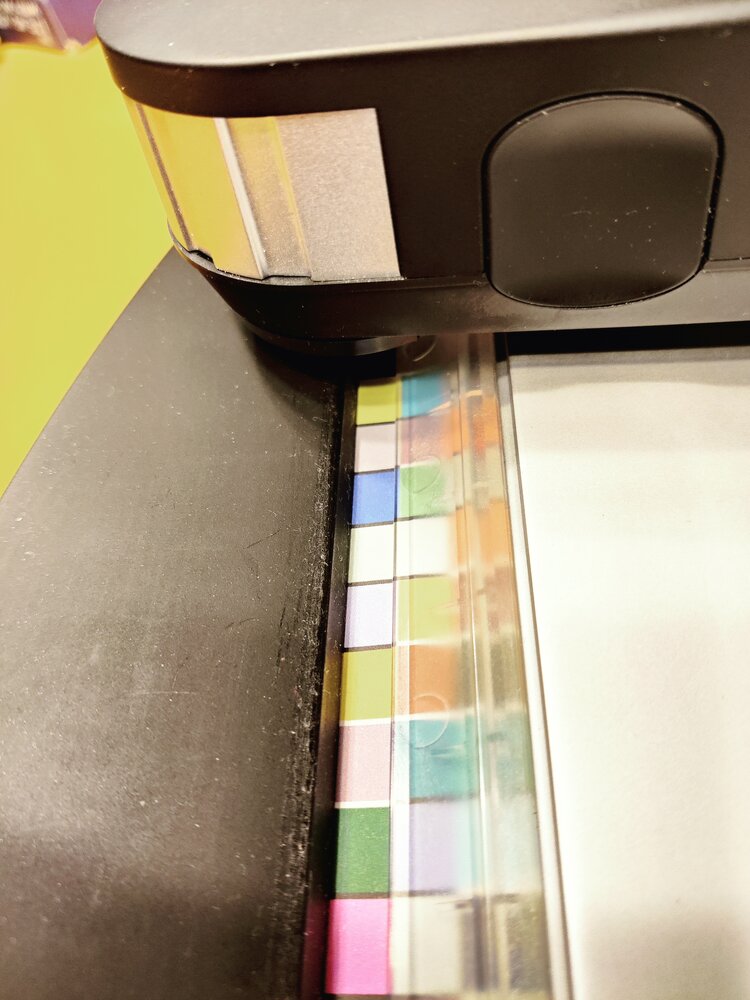

The reason is this when you put the target on the scanning table:

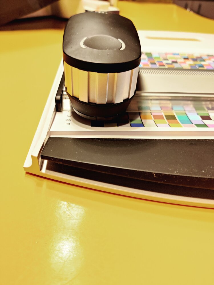

It must be pressed under a paper clamp and when too high the first few rows cannot be scanned as the i1pro2 is lifted upwards by the clamp:

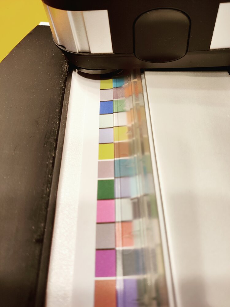

To overcome this I have to move down the paper, but as such the paper is no longer pressed under the clamp:
The downwards placement is necessary because of this:
When aligned towards to right side the scanning eyes stopped on a patch, NOT on a white area of the paper (important for scanning: it needs to start from paper white and ends on white paper).

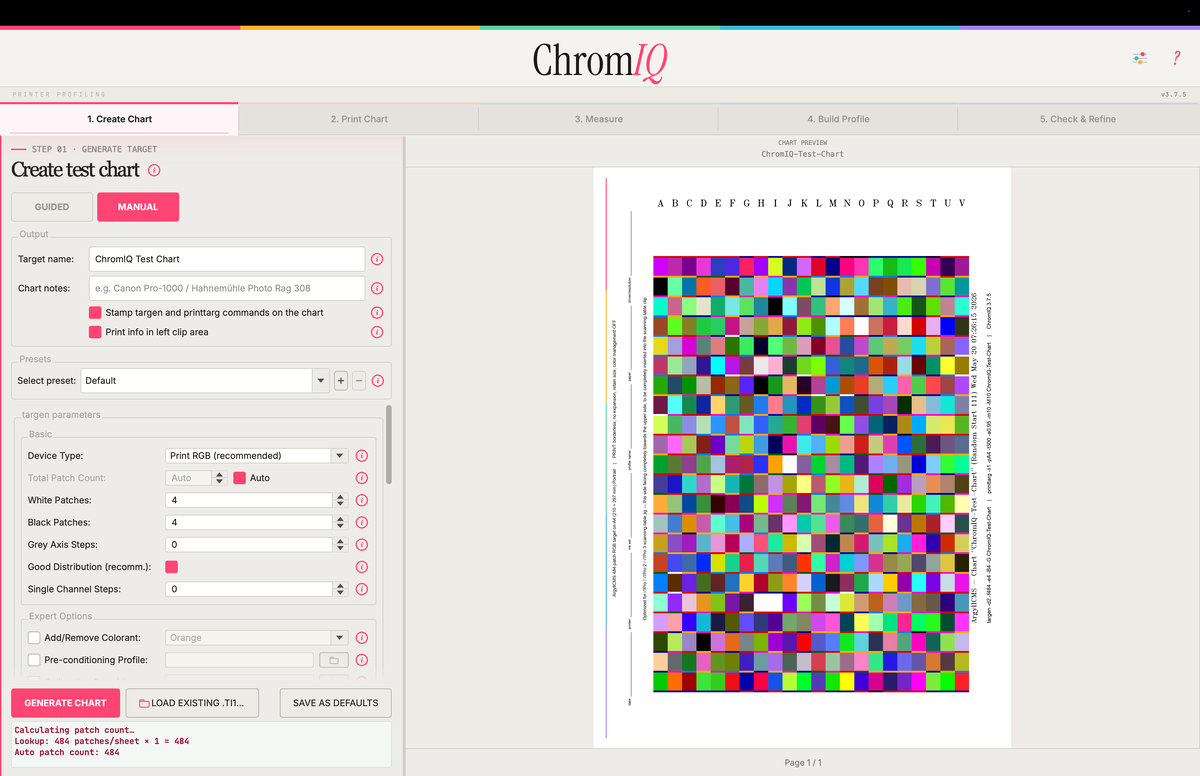

In the latest version I made some adjustments for the i1Pro defaults. You mentioned before that it would need a margin of 10 instead of 6. I implemented this earlier already. Then on dpreview someone was confused why in my app one less line fit on an A4 page for the i1 pro. In your earlier screenshots I noticed that you set the patch size scale to 0,95. this compensates for this. So this evening I ran some more tests to extend the apps database and give the user multiple defaults for the i1Pro. You can set this in the settings.
When I look at your screenshots it seems that for the layout you prefer the option to suppress left clipping border is not turned on. I think in my app it is on by default to use more of the space on the paper.
What you could do: turn this option off once and figure out the values for margin and patch size scale so you still get the same amount of patches on one page of A4 and then either save this as a general default for this tab with the button on the bottom or click the little plus icon in the user preset section to give this set of settings a name and save it as a preset.
What I could do then: if you think those settings are good I could run more tests to further extend the database. So the app does not always have to do iterative tests to figure out how many patches fit one page for this settings. And if you like this section on the left where you can write down some notes I could probably copy that and automatically print that on the target when the clip border is not suppressed. Do you like this idea?
By the way one of your first suggestions was that the targen and printtarg setting should be printable on the targets. I have already inplemented this as well a few versions ago. It is in the output section where you enter the name for the target. You have one entry field for free text and a checkbox to print the settings. In guided mode the settings are always printed. Do you like this?

Maybe a cosmetic correction to be done: when I try a Colormunki-like method (50 + 50) with the i1pro2 but now using 240 initial patches > preconditioning target created > create 240 new patches on a single sheet of A4 and I check: "Stamp targen and printtarg commands on the chart" and would like a single sheet of A4 paper (landscape: preconditioning on the left half paper and the final target on the other side, I get this:
You see the text is printed on the area I want to print the secondary target, thus rendering this area useless.
Maybe the text should be printed much closer to the target like this:

Already working on something. But need one more tweak to move the patch set over to the right and I have to test whether the highlighter for measurement will work with this layout.
Regarding your second question: I am not sure why it puts it in this spot. It should put it on the very right side of the paper. Maybe it did not expect this much unused space or it puts it right in the middle between the border and the printtarg text. But working on your other feature request first.

I noticed that I don't really need those values. I found a solution that is adaptive to a degree. So you should be able to choose whatever values you prefer. Still doing some tests though.
