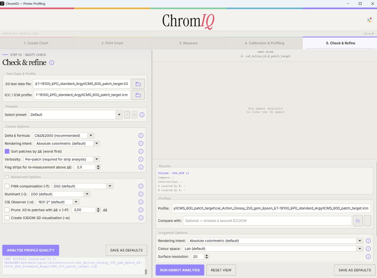

Thanks for the update. I find the light version almost unreadable, because the letters are so light in my case.

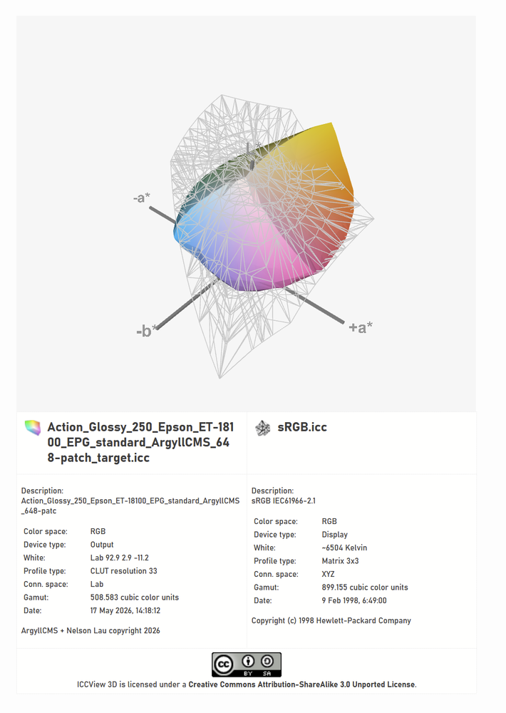

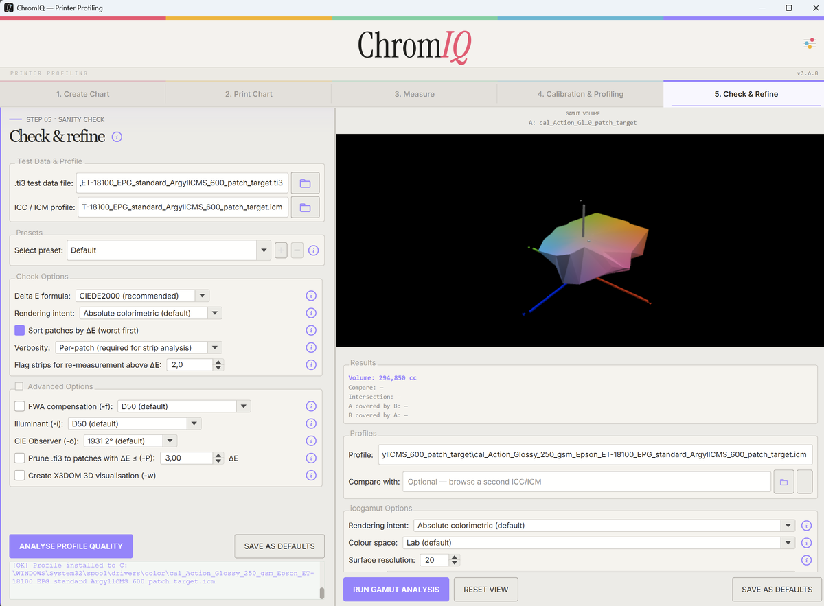

But I still cannot get a good profile, despite 600 patches:
I get a very strange flatten 3D profile:

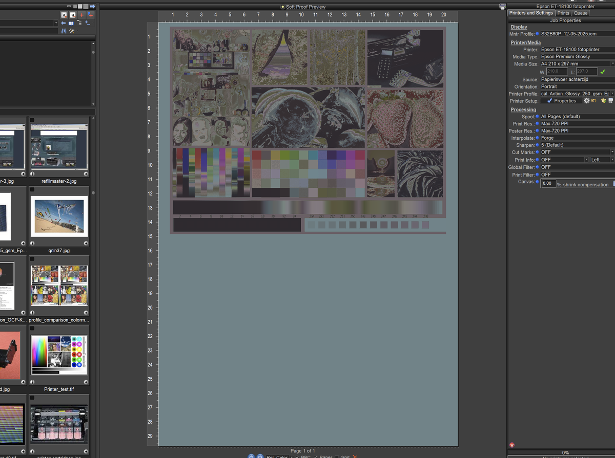

The profile is unusable when I try soft proofing checked:
Wow, this looks horrible...
1. I added a light mode because somewhere else someone was complaining that the dark theme would hurt his eyes. Might still need some work probably.
2. I would need the exact steps you took to try and reproduce this to figure out what went wrong here. Best would be to have the data from the log file and maybe even the files that were created.

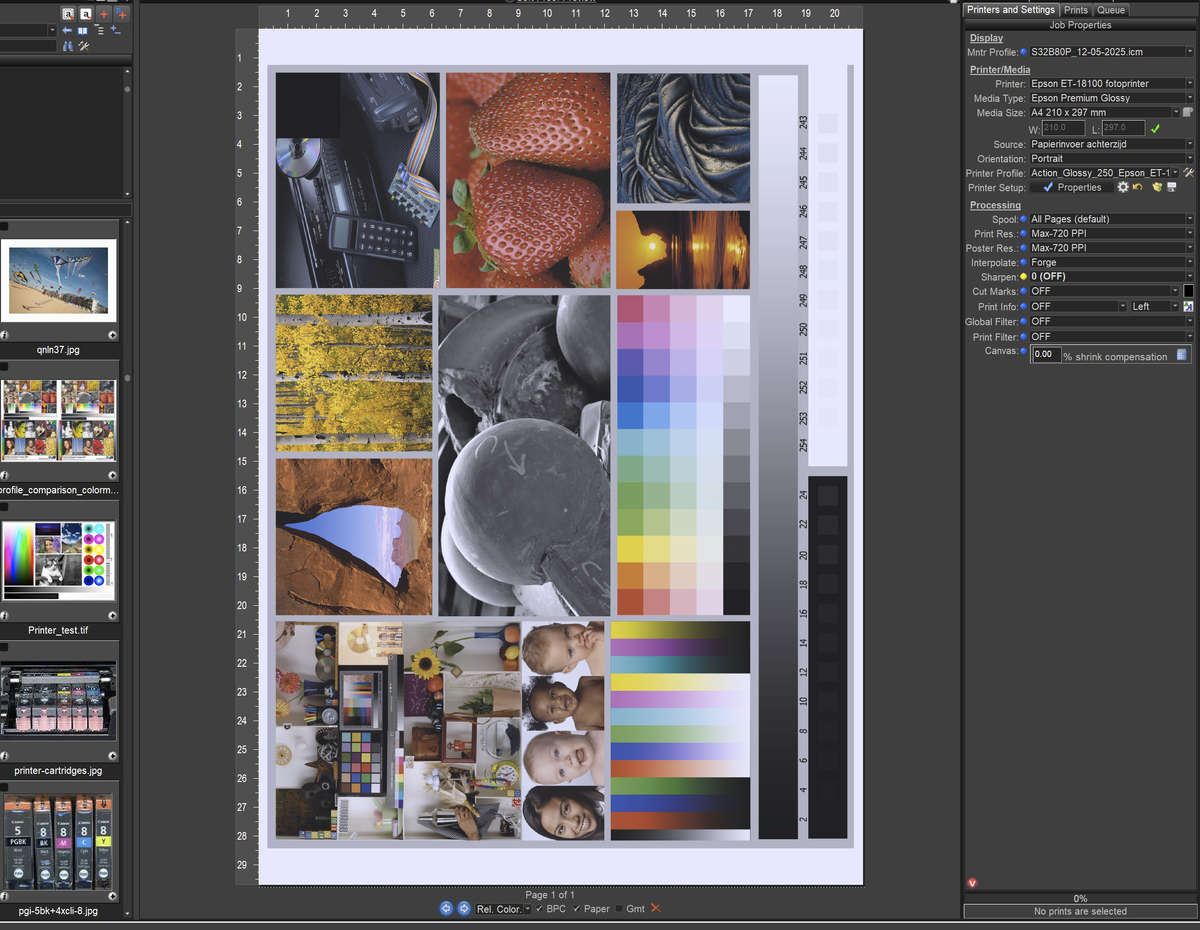

OK, I just keep on posting feedback. For comparison here is my profile generated with old school commands in dos box for a 648-patch target:
Above profile seems to be legit and here is the profile in action in softproofing in Qimage:
The profile is ok with the old fashioned command typing method in ArgyllCMS.......
