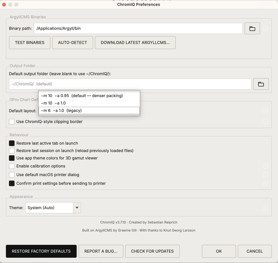

In settings there is a new section where I tried to implement pharmacists recommendations to use the i1Pro more effectively. In the dropdown choose the legacy option. This uses Argyll defaults for this device and try again please. I just tried again with your commands and it is giving me the expected results. Again: sorry for all of this back and forth. I am trying to learn from all of the feedback here. But what is right for one person seems wrong for the other. It is hard to find the right mix to make everyone happy.

Again, I am sorry for this confusion. Maybe I make this the default again as this is what most users would expect and leave the other setting optional.

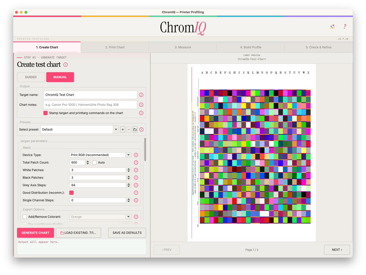

I have found the culprit: it only works in guided mode.
In manual mode:
Als I have discovered with the guided mode AND multiple pages: no "page x of y" printed on the legenda

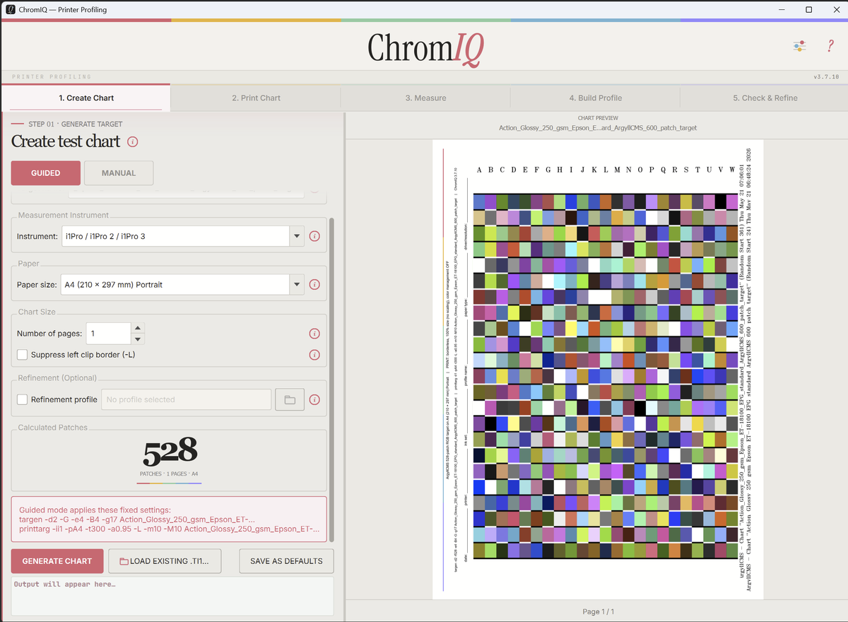

Tip for guided mode: use the following standard targen arguments for 1 page (528 patches):
targen -d2 -G -e4 -B4 -g32 Profile_Name
This will improve grey separations (currently: -g17)
for the current setting for printtarg (-a.95) you can easily cramp up to 600 patches per A4 without any problems
(some photoshopping putting the above 600 patch target onto the guided target):
for multiple pages: multiple "-g32" with the amount of pages, thus for 2 pages: -g64 up to maximum -g128 (more is not really needed). The -e4 -B4 can indeed be increased with 50% with each additional page (not more than -e8 -B8)
Thanks for the tip with the guided mode. This is something I have been waiting for and I will adjust this. However Please tell me what other settings you are using in manual. I have just entered the same values as on your screenshot (the ones I can see) and it works for me.
Maybe my math is wrong but the target you photoshopped in guided has only 529 patches. That's the rreason there is a second page in manual I guess.
Sorry I will update later my fault but 600 should be possible let me figure out
New version with adjusted guided mode settings is uploading. I took your values as a base and let it calculate from there. For instrument and paper combinations that fit very few patches there might be some deviation. But in my opinion the guided mode should only give users a good starting point and does not need to perfect. Manual mode leaves room for improvements and you could share presets for example. Therefore I will probably not squeeze the last few possible patches out of the i1Pro for guided. I consider this for inexperienced users who might prefer slightly larger patches to have a little more wiggle room. See for example Alan. I do understand that it is confusing when the app uses other defaults for the instrument as someone might know from years of using Argyll. So I am not sure which defaults I will keep for this. I would like to do everyone justice. But someone likes it one way, someone else like it the other way. It is hard to find a solution to satisfy everyone.
