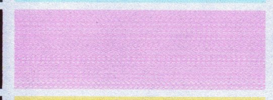

Could this have just been a defective printhead from the factory that I didn't realize until it is too late?
Because if it wasn't getting full ink flow, it would be slowly overheating/damaging itself and getting worse over time? Or am I wrong and they might just be separate issues?
I find it weird it would be a clog because if you look really close the "line" that should be clogged comes one and off in a pattern.
Like it looks like it is skipping or only firing those nozzles part-time?

I carefully viewed your “Morning” and the “Now” nozzle checks and could see just a little improvement, so using you printer is helping to clear the print head back to normal, so just go on using the printer for your work..
I reckon it was the use of the aftermarket carts that caused the print head to show signs of clogs and failure and if you stick with only OEM inks for a short while the print head will recover back to full print quality.

I think there is a problem with the sealing cup or piming circuit.
I thought to read through the thread but it is mucho confusing. However I have picked out a few salient points.
1. It starts with a new a New Pro-100 on OEM inks displaying some form of clogging. Should not be happening...points to hardware defect. OEM tanks and My refilled inks can lay dormant for at least six months and come back alive perfectly PROVIDED the printer hardware is working properly.
2. Author then indicates that ink levels are not reported properly all the time. The ink remaining is always greater than what the chip says.
This should be another hint. If the printer is not pulling the correct amount of ink through the printhead as would happen with a defective priming circuit/system then there will be greater amounts of physical ink remaining than what is supposed to be estimated by the chip. Chips do not misbehave, if they do, they are gone and should be replaced and then this is rare but possible. Rare though.
It is unlikely to be a printhead issue but at this point it could be that as well if the printhead was damaged now ( depends on how much printing was done when the problem initially surfaced.
Defective priming circuits will display improper wetting of the nozzles. This can lead to A. Bad nozzle checks ( Check) b. Streaking (check) C. Real clogs but worse is the possibility that eventually the nozzles will be overheated and become fatal because the printhead is operating in a situation it should not be.
The proper thing would have been to have the printer replaced intially. At this point, replacing the printhead might be attempted and if it is the priming circuit, then the printhead could be damaged again but.
My bet is the priming circuit. Possibly a loosened tube or improper seal. One way to check is to carefully weigh each tank to 0.1 gram. Perform a head clean on all colors and then immediately weigh them all again. See how much ink has been consumed and also whether each tank is reduced the same amount. The tanks should each weigh at least 0.4 grams less or greater after a head clean. If they don't, it is likely that the circuit is at fault. ( 0.4 is for the priming cycle itself when the lid is lowered)
For the solution, someone skilled in the disassembly of the printer should help at that point. It is not the ink, it is not the refilling perfection, but it lies with the printer body. It could also mean a printhead replacement as well, and "it depnds".

I measured each cartridge with my scale (not the most accurate so I took three measurements while zeroing out the scale in-between each measurement)
The measurements were as follows
M - 23.7g (refilled cartridge didn't go full full so that's why it's a lil lower than the others)
PC - 24.8g
Y - 24.6g
BK - 22.9g (refill as well)
GY - 25.2g
PM - 25.1g
LGY - 24.8
C - 24.6
The only change was BK and PM of a loss of -0.1g of ink ( but this also may be withing the margin of error of the scale)
So nowww I would assume this pins it as the purge unit?
I also did clean the gasket around the purge unit and did a "leak" test of it by placing distilled water onto the purge pads (although they are hard as a rock, normal?) and the water would sit in a pool, I came back 5 mins later and it was still present, ran a cleaning cycle and the water got removed.
/\ this was suggested from this link https://www.printerknowledge.com/threads/urgent-help-canon-ip4920.7972/page-4#post-66333
