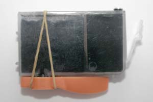

1. When you install a new cartridge, the instructions tell you to discard the plastic cap that covers the discharge hole. I figured that if this cap was good enough for the supplier, it should be good enough for me. The only problem was how to hold it in place easily solved with a rubber band. This works great not only for refilling it also allows you to store multiple set of carts without leaks. It is a good idea to rinse the seal surface with tap water and blow it dry so that you dont have to worry about residual ink on the seal surface contaminating a different color cart. Install the rubber band with one loop in front and one loop behind the hole to balance the loading on the cap, and then wiggle the cap to make sure that it is square on the cart.

I have tried the rubber band and the original cap over the exit port trick .
2 points:
1. Need to use the caps that came with the cartridge. Had some trouble trying to get the caps to seal when mixing oem caps with non oem cartridges and vice versa.
2. Also worth smoothing out the small broken pieces of plastic that originally held the cap in place, so the cap can sit squarely under the force of the rubber band without getting skewed.

Here are small pictures of the cap, sponge/filter and screw seal:
http://www.nifty-stuff.com/img/files/Cap1.jpg#img
http://www.nifty-stuff.com/img/files/ExitFilter.jpg#img
http://www.nifty-stuff.com/img/files/ScrewSeal.jpg#img
Ocular - I agree with your points, but I have found that I can mix two "nib" (the little connectors that initially hold the cap in place and break when you first remove the cap) and 4 nib caps caps and don't have to grind down the "nibs" if I just wiggle/twist the cap so that it isn't resting on the nibs. Your way is obviously safer, but I am lazy. I have only mixed caps from Canon and InkGrabber carts, and it could be that some other caps might not be interchangeable.
