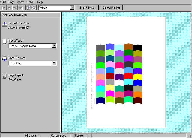

I have run it again with the same result, double click on thumbnail to enlarge image of last printer window.
Try it yourself, see if 9500 is the same as 9000 II.

I never use print preview so I will try this out soon. It seems strange that the borders are ignored with the fine art paper setting.

If you look at the small window which shows you ink status and printing progress. When you print CM test charts it says "Bit map printing test", so this may be why they behave differently.

I had a look through the Xrite ColorMunki directory to see if I could find an image file, containing a profiling test chart, but did not find anything.
This leads me to the conclusion that CM generates the test charts as bitmaps, each time, as required.
Thus, unlike some other makes of profiler, there is no chart to send to anyone, for whatever reason!!
It is a clever approach and facilitates their profile optimisation process, giving a more or less unlimited multi patch mechanism directly tailored to the type of images you are producing.
I must say it has worked exceptionally well in all my tests and the profile files get bigger as you go.
I think the bitmap printing of the charts is why they do not behave like ordinary image files on your fine art papers Rod.
