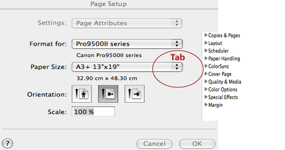

Hi, I have done a several tests and some research. I'm about to give up, but maybe some of you Printers have had a similar problem and can enlight me.
I have Canson Watercolor paper 12x18 in (not the inkjet paper, but regular watercolor). After watching some youtube videos I have seen some successful prints on this paper with Canon Pro-10. I'm using OEM inks, and I want to use Art Paper mode in order to be able to use the Matte Black for better blacks on this paper. But whatever I do I can not make it to work. It maybe because of I use Mac? One person told me he could print on that paper in custom page setup. He uses PC. However, I was not able to do it.
I'm printing from Photoshop. The printer driver does not have preset 12 x 18 in for art paper. I set the custom size and set the non-printable area to 1.2 in margins (which is roughly 30mm). I select the art paper in media tab. That does not work. The printer gives me a little exclamation sign in the printer driver icon (no explanation of the error can be found). And it does not proceed with printing. I tried using the Canon Print Studio Pro (a pain to install on Mac for Photoshop!, btw). But the plug-in does not even have a custom size option when Art Paper is selected. The custom size is grayed out. And no 12 x 18 in preset is available. Is there really no way to print on 12 x 18 art paper on pro-10? (I'm surprised, for this is a professional printer after all).

@Jim Darski, The problem your having is a very common one when using a Mac to print with, you must tell the O/S what size your intending to use in the same way you do with in print driver.
Here are some pics to help, you may not need all of them to get where your going but they should set you in the right direction, O’ a little tip check every setting twice before committing to print...
Mac’s are very easy to use but their print setup hasn’t change since Adam was a boy and it’s a bitch to get use too...
P.S. One Pic shows Page setup and another shows the Print setup, they much match for it all to work..

Thanks so much for the instruction. However in Photoshop there isn't much I can do to match the printer driver dialogue box. Paper size and margines can be only selected through the Print Settings - which is the printer driver. The only thing I do in Photoshop is the Color Profile. The paper size and boarders selected in Print Setup are reflected in Photoshop print panel. And they show correct boarders of 1.2 in as in the Print Setup window. I looked through the Photoshop print panel and the Print Setup window. Everything is setup correctly. But the printer does not print. :idunno

If you were printing from windows that might be the case, however you can set paper sizes in Photoshop itself, as I pointed out there are two separate places to set Paper sizes in, Photoshop and Mac O/S.
You start by opening your print in Photoshop, and by using this Tap
you can configure the printer to your requirements, but to print successful you must also instruct the O/S print spooler to send the same correct Page size to the printer, and if there is a conflict then the Print Spooler cancels the print command.
Continue by clicking on print but this time go through the O/S Page setup once again, the Print setup much be the same as the Printer Page setup, you’ll find many many settings in the Page setup Tabs and then you can click on the Photoshop Tab to check that both settings are the same, and when they are it will print...

I have encountered this issue in Windows too. When you select one of the Fine Art papers in the driver (that includes Canon mate pro Premium ) you are limited to a paper size with 30mm borders and there’re only five to choose from : Letter, 11x17”, A4, A3 and A3+
You cannot use any other size, included custom. Scale to fit won’t work either. The Pop up warning dialog would appear again requiring you to select the “correct” size for Fine Art (i.e. one of those five with 30mm. borders)
This has nothing to do with Photoshop. It's imposed by the Canon driver for the Pro10 ( other printers may behave different). I wouldn’t know if there's a workaround for this issue in a Mac computer. In Windows there isn't.
For 12x18” paper the only thing to do would be to select 11x17” and accept the waste of one extra inch of paper as the lesser evil.

@Artur5, The paper size limit in Canon Page setup is a bit of a joke, but it can be easily over come by setting your media setting to Hagaki, and that way you have no restrictions on over sized margins or Custom paper sizes.
You can also use whichever Black ink you wish by simply swapping or having a dedicated cartridge filled with your choice of Matte/Photo ink, but don’t get them mixed up and this procedure does require a Custom profile if you’re really picky...
It's a Canon thing and it has nothing to do with the O/S..:mad:

Just how do you get to that Paper Setup page? When I click on print, it does not open any OS print panel. It sends it to the print queue without any additional step. And there is no Page Setup button in the Photoshop print panel. It's all done through the Print Settings, as far as I can see. Any idea? :hu
