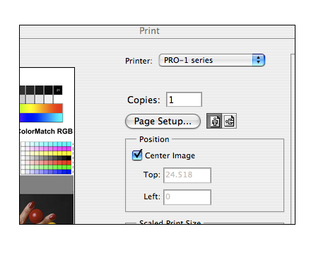

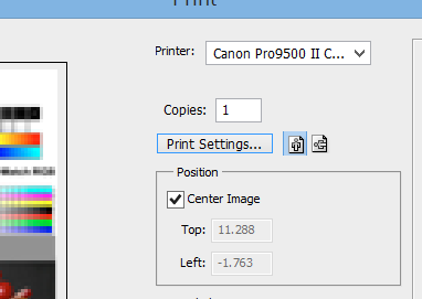

Just how do you get to that Paper Setup page? When I click on print, it does not open any OS print panel. It sends it to the print queue without any additional step. And there is no Page Setup button in the Photoshop print panel. It's all done through the Print Settings, as far as I can see. Any idea?
Photoshop in Mac has a different setup to photoshop in Windows, there are two different Print Tabs, so your print size in windows/Photoshop can be set in Photoshop but on the Mac you can only set your Page size.
Capture10.PNG Capture11.PNG click to enlarge
Before you print go to your printer preferences and make the paper size the same as you have just set in Photoshop, when both are set the same then it will print for you, I have been away from Mac printing for quite some time, so forgive the forgetfulness on my behalf.. :(
View attachment 7939 View attachment 7940 click to enlarge

Printing must be an prohibitively expensive hobby in Europe. But even in the US. I still can't quite justify why I bought this printer instead of going to my local Walgreens store to print for a few cents per print. It's just that I needed to print some illustrations and artwork which I needed a bit more control. Well, control is something I can't clearly get right now. :barnie
Anyway, I'm away from my printer now. Will check that later this evening. But as far as I remember the Photoshop print panel looks different now. There is no page setup. Instead there is "print settings" like on your Windows pic. And by clicking "print settings" you enter the printer panel in which you set the paper size. I don't know if there is any other way to set the paper size at this point...
