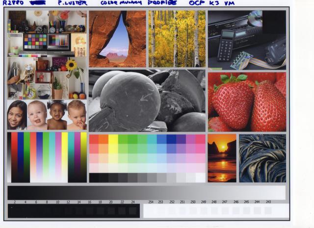

OK, I did made a few prints on several types of glossy paper and indeed the type of paper does influence the amount of glossiness. Netbit, Epson Semi Gloss, Moab, TPI Glossy do beautifully well. HP Glossy paper is suboptimal and causes the magenta to be muted down.
My overall impression of this ink: for the price the results are just fantastic and glossiness is more than satisfactory (Epson K3 Vivid still rules supreme). ABW-mode is good (a bit warmer) , but Inkrepublic's IRK4-nano Vivid produces a much more neutral print.

OCP K3 using Epson Profile
EPSON OEM INKS Epson Profile
OCP K3 after Profiling with COLORMUNKI
