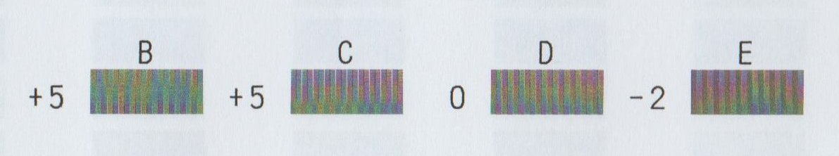

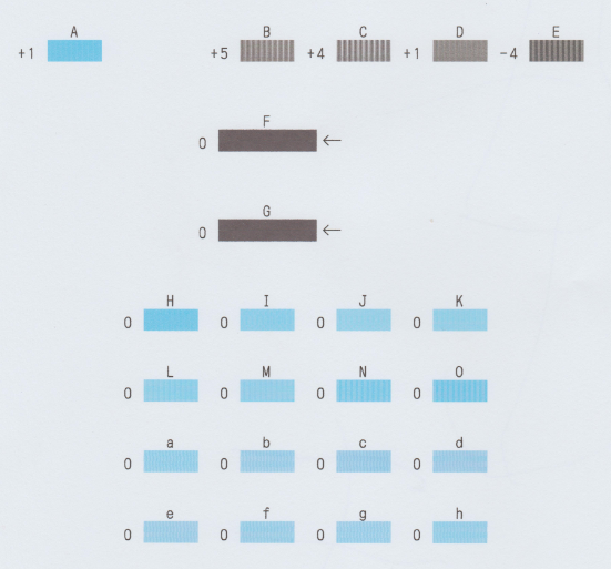

These are results I got.
strikes values table (see attached rar file)
After print standard I get bad result:
res:
  • 2016-11-07.rar
5,064
4,914
I unpacked the .rar archive and it looks to me that there are problems with columns B, C and E. I would select values of values of B=5, C=5, D=1 and E=-2. This is very much the same as you selected.

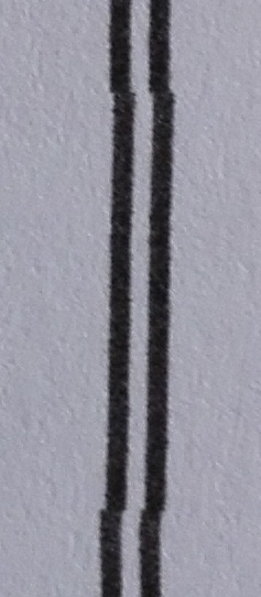

I think the broken vertical lines are likely caused by bad print head alignment, but they could also be caused by a dirty timing strip. You could try cleaning the timing strip with a piece of soft tissue paper moistened with a window cleaner with ammonia. To get access to clean the timing strip: Open the printer as if you would change an ink cartridge. When the print head carriage is in the cartridge change position pull the mains cord without first turning the printer off. You can now slide the print head carriage from side to side. I don't know your printer but hopefully you can now access all of the timing strip for cleaning.

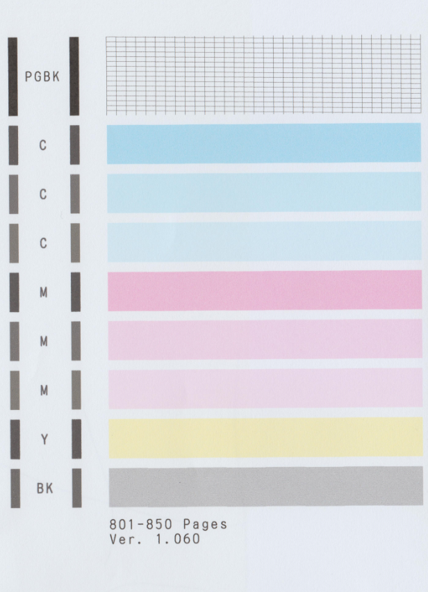

@PeterBJ I change to refillable cartridges PGI-450xl, CLI-451xl ?! Maybe its reason for this ? Print Head nozzle check OK,
I 'll try cleaning timing strip maybe help.
5,064
4,914
I don't think the refillable cartridges are causing the problem as the nozzle check looks perfectly fine to me.
Your values not differ from Automatic align !! see post #2.
