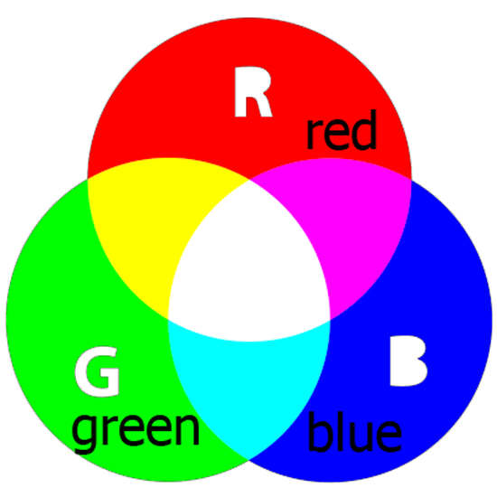

leo8088, what about the pigment black text over colored background on normal copier paper (not inkjet coated paper). Any idea does the pgiment black text bleeds? For eg:

I don't have an immediate answer to this question. I do not print such graphics like that. You should try to print with all dye inks. It is a common sense to me to print graphics (photos) with dye ink. If the paper you use is the cheap copy paper you obviously are not seeking much quality. If you print with dye ink your problem is solved. But if you have plain black text on other part of your document you can print it separately. This means print the graphic only first. Then put the paper back to the tray and print the text with pigment black ink again. This is a 2 pass printing. It is an easy solution.
On the other hand, if you want the print to be in absolutely the best quality there are some coated inkjet paper of Canon and Epson brands that are really the best for this kind of print. The entire print will be printed with dye inks only. The graphic part will be as vivid as it should be and the text will be deep dark and very sharp. Some of such papers are coated on both sides too.

leo8088, not photo. But documents. Above image is Just an example for text over colored background. I don't why you think it's photos or graphics only. Documents can include both text and graphics. Such as manual, statistics report with charts Pie chart, bar charts etc or all other document where it can contains some graphics within a page of textual document and not a full page of graphics or photos.
It doesn't matter. I probably wait for ghwellsjr to help feedback on the KMP on this aspect.

Just for an exercise on the dye and pigment black that I use, I borrowed your Colour Ball scan (hope you dont mind) copied it into Illustrator and stuck the three words in it and printed it out on two different Canon printers both on standard quality printout. I put the two prints together and scanned them to PNG format then stuck in this tread for feedback. I wanted to test the amount of spread (bleeding) on the coloured background using just plain copy paper with two different black inks..

Hi Hat, generally the dye black text over black colored background do not imposed much of the problem (assuming black dye ink was being refilled in PGI-5 and the rest of the color being dye ink) .
The picture I posted is with one pigment black ink that has this problem whenever it was printed over colored blackground. The reason was being that some of the pigment ink took a bit longer to dry. As such when it's printed over colored blackground it bleeds. However, Not all black pigment ink has this problem when it's printed over colored background. Which is why I wanted to know the quality of the black pigment ink over colored background when printed on normal copy paper.
This is another picture with black pigment ink over colored background which does not have the bleeds issue.
(Printer Print Mode : Standard Print Quality, Auto Color Intensity, Plain Paper Setting)
And you may wonder why test on normal copy paper. Because I wanted to know the quality of the black pigment ink. Would you do the "water-resistence" test by printing dye ink on inkjet coated paper and wash them with water and then tell everyone that the dye ink is water-resistence and does not runs ? No, because you know that dye would adhere well to inkjet coated paper and does not run when the print is in contact with water. Similarly also, would you do the highlighter test of black text that was printed with pigment on inkjet coated paper? Again, no. You would test it on normal paper.
That is why I was asking leo8088 since he was showing the black text alone with Hobbicolors Pigment black. I don't need to know that I should try using dye or on better paper or higher quality setting mode or set the print to High Resolution Paper or such. I don't need another "Tin Ho" answer on this.
If 2 set of pigment black has the same comparable price (maybe different by a couple of dollars eg $1, $2), however one has a better quality over another. Knowing that, you could decide for yourself which one would you want to get.
I wish I had the chance to test the KMP. Maybe one fine day.
Your image on the bottom (where it was printed with pigment black) looks good and does not bleeds badly like the one shown in my picture (at post #35) which was taken 2 years ago. What pigment black ink did you used?
Here is the image I used to print the above picture.
