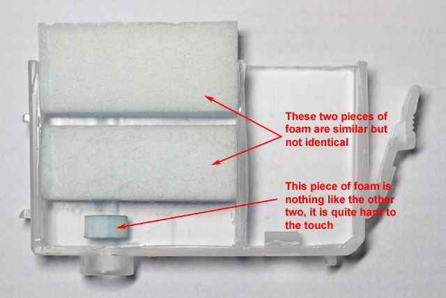

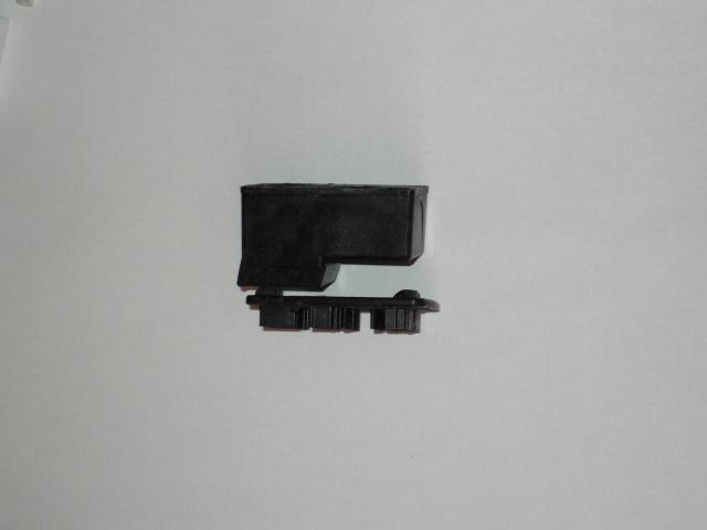

This is how the CL-811 cartridge is built:
-top view:
-side view:
This is how a BCI-6 cartridge is built(the type of cartridge for which the german method is designed for):
For more pictures visit http://www.nifty-stuff.com/forum/viewtopic.php?pid=40438#p40438
On CL-811/PG-810 the printhead is integrated in the cartridge and there is no separate ink compartment, so it's preety much different than the PGI, CLI, BCI...
