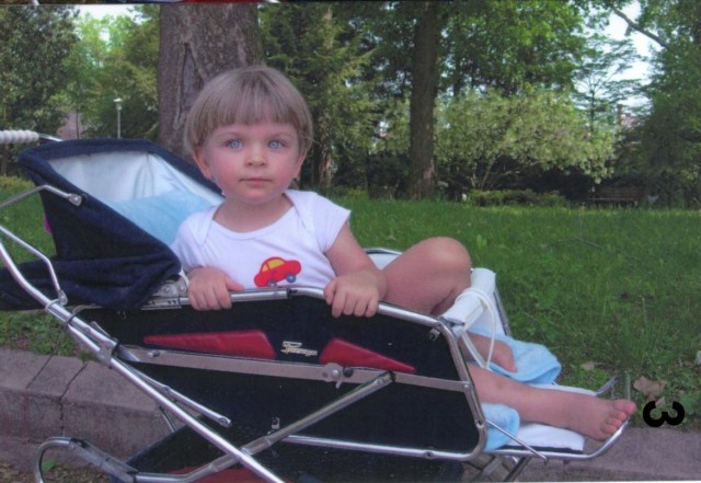

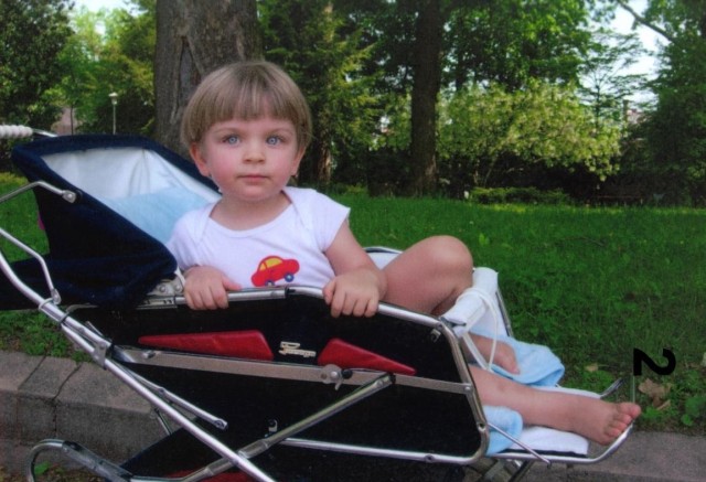

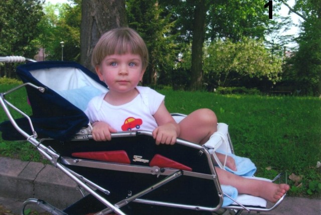

O.K. - Here are some very unscientific results: Using automotive clear (acrylic laquer from my garage shelf of a of an older vintage than I care to admit) I coated 3 identical 4x6 prints - 1) Kirkland glossy, 2) Matte photo; and 3) Nexxtech smooth photo paper. I allowed a mist coat to dry a few minutes followed by a few progressively heavier coats, all at about 65 deg. F. Once dry, about 15 min, I noted no change in appearance, except in the matte photo, which began to look as though a few more coats would have converted it to a satin or pearl finish. I held each print under a steady stream of room temp. tap water for about a minute with the edges cupped slightlly to avoid contact with areas other than the front surface. No penetration or change of any kind. Frankly, I was amazed by the absence of any bleed in the prints, which were all made w/ a i960 printer w/MIS inks. I'll send a scan of the results to rob for his inspection & comments.
Best Regards to Everyone, Mark

Mark, the only thing that seemed to be missing from your experiment is the non-sprayed prints. I took some kirkland photos and ran them under some water and was pretty impressed with how water resistant (not waterproof) they were.
Do you (or anybody else) care to do an equal experiment with card stock or regular paper? Maybe I'll see if I can pick up some of this spray and try it.
Oh, and here are Mark's prints:
http://www.nifty-stuff.com/img/files/mark1.jpg
http://www.nifty-stuff.com/img/files/mark2.jpg
http://www.nifty-stuff.com/img/files/mark3.jpg
