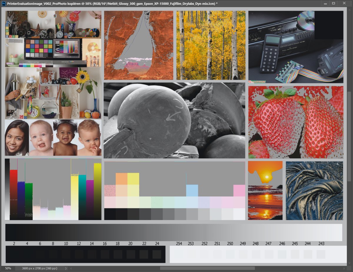

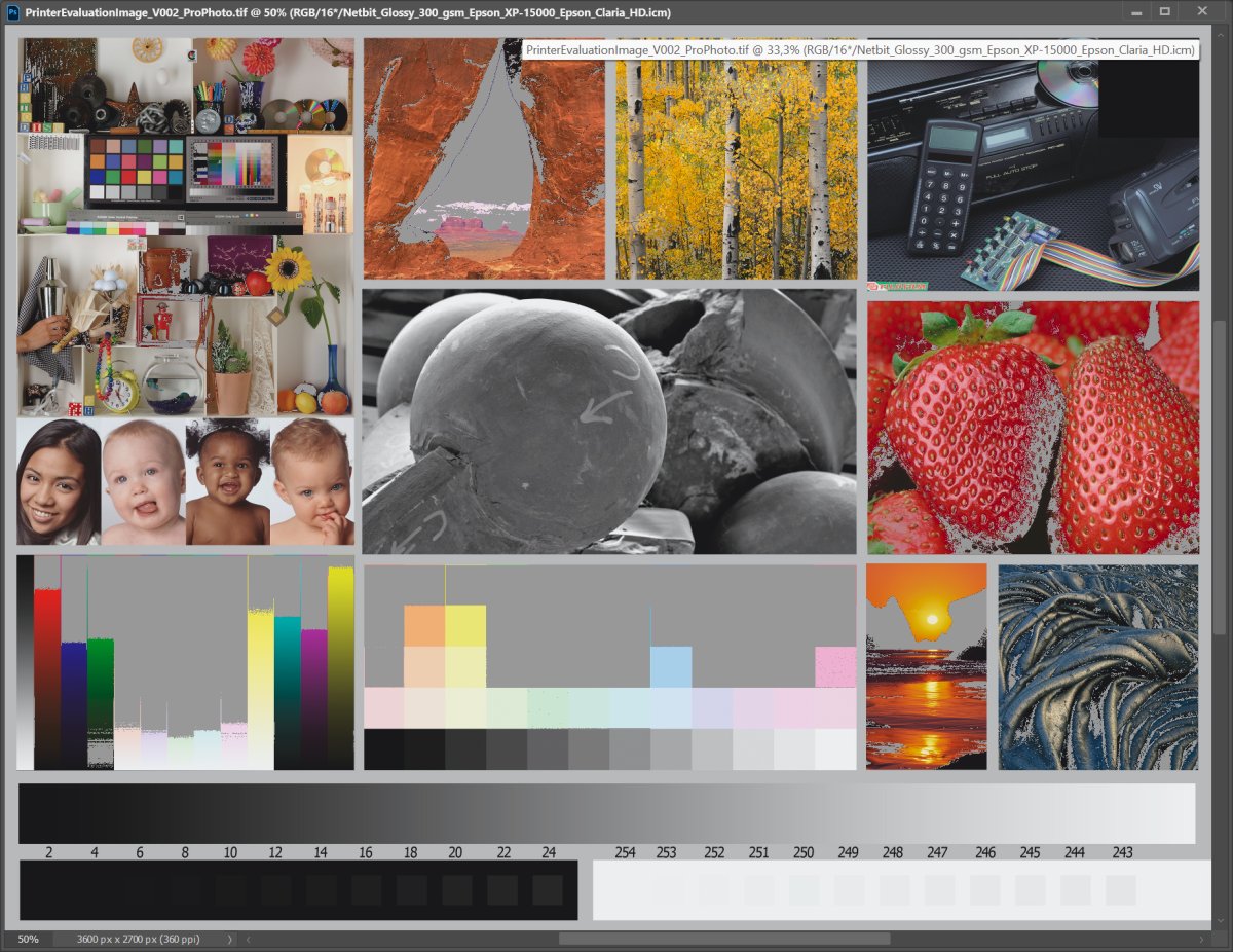

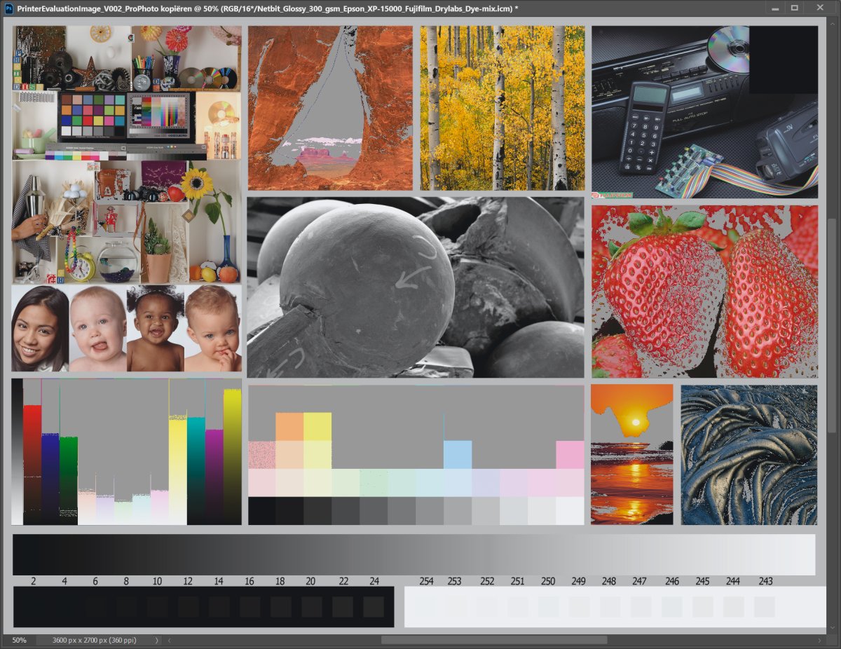

Softproofing with profiles: colours that cannot be reproduced by the printer are grayed out.
as you can see: hardly any difference. Note the reds of the strawberry: Claria HD has a slight edge over the mixed Red made with Magenta and Yellow (80 + 20 parts).
that i mean @Ink stained Fingers is, seeing the original posted Evaluation Images from @pharmacist we can see that original Red (the upper image) is a little stronger of the Mixed Red (the lower image) maybe a bit of Black or more Magenta will give a stronger Red ? anyway after profiling we will have no difference, it was just to get the same Red so profiling could be avoided for the Epson papers listed in the driver, for 3rd party paper it will be always needed.
