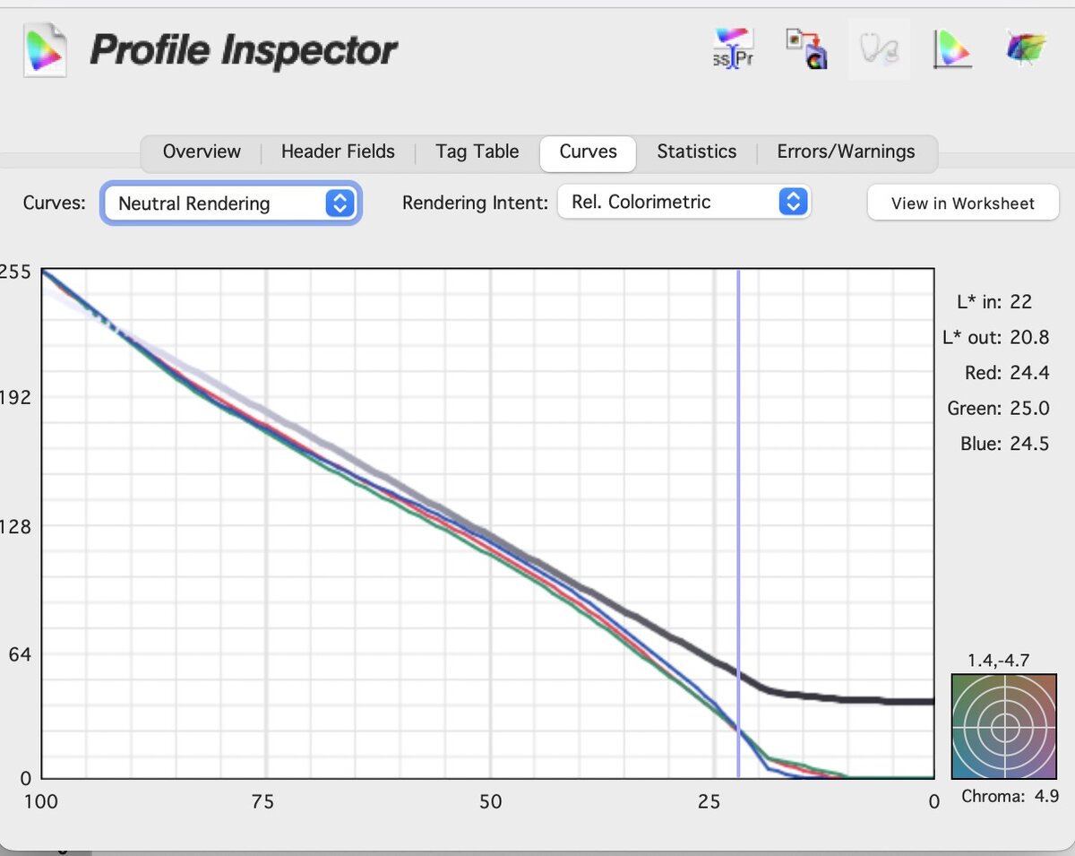

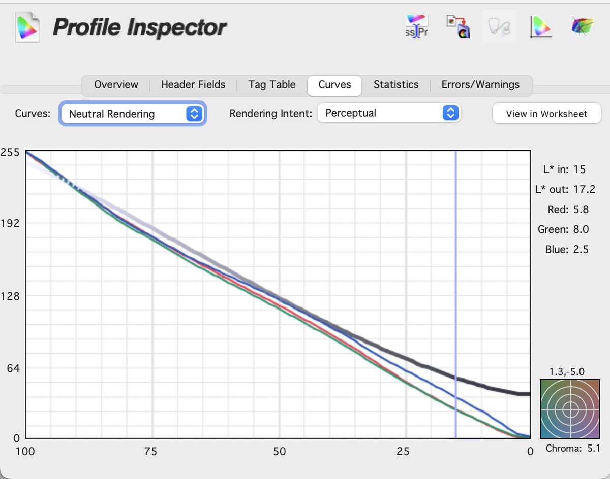

- And lastly are you using perceptual rendering? Let me show you the curves in the Red River ICC profile for relative colorimetric vs perceptual. The almost flat line on relative colorimetric is concerning
Relative Colorimetric:

Perceptual
Check, check, Perceptual, check, and check.
Perceptual
Again excuse the lack of my expertise yet I know sharing details both direction can help forum members help you better in solving your problem.
Thanks. That's really helpful, more than you can know.

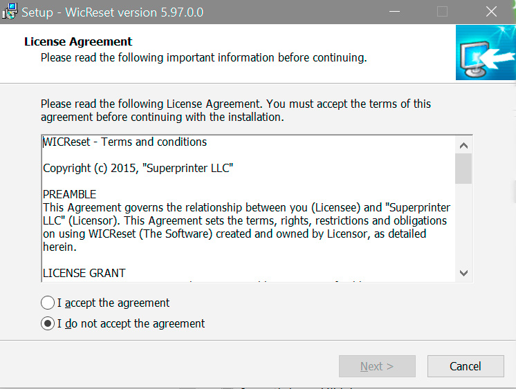

You are a liar.
The WicReset program does not need to be INSTALLED, since it consists of one executable file. It just needs to be downloaded to any folder and launched with one click of the mouse. Your letter does not make me laugh.
wicreset.exe from the link you posted:
"before continuing with the installation"
wicreset.exe isn't signed. A google search for "Superprinter LLC" returns a single hit which is a Malware analysis of weireset.exe with the conclusion of "Suspicious".
Via the two obscure payment processors they use (2manuals.com and payproglobal.com) is the only way you might be able to find out who or where the producer of this software is,
There is probably nothing wrong with it. however, it is certainly not the kind of software I want to install or run without very good reason.

I contacted a Red River technical support person, and she was very helpful. A single shadow adjustment in Gimp ameliorates the problem, and as a bonus, it's a local contrast adjustment that I didn't know about. I'm now using the Velvet Fine Art paper setting (with my own profile) that Jose Rodriguez and Keith Cooper mentioned. The Red River profile and recommended settings seem to work as well or almost as well.
Nevertheless, I don't think the BPC and perceptual rendering systems are working quite right. Matte paper offers pretty good blacks (beautiful, actually), with a reflectivity reportedly around 2%. I have the pictures to show that matte paper can reproduce the pictures I want. The problem is that I have to make large manual brightness corrections. The profiling and printing software seems to handle this automatically for glossy paper, but it works poorly with some matte paper, and it doesn't even use all the range of black tones.
