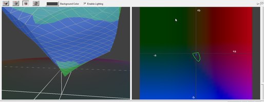

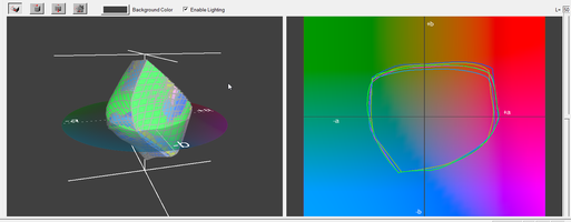

I did a test with a matte paper on the ET-8550, I created icc-profiles for various different driver settings; I used a matte paper Brilliant 230gr, I cannot affort to buy a complete A3+ Epson pack of the Velvet Fine Art , a sample pack/sheet is nowhere available. The coating has the most impact anyway.
I'm using these paper/quality settings, all on the same Brilliant matte paper
https://www.brilliantpaper.eu/en/co...blatt-matte-doppelseitige-beschichtung-230g-m
Normal paper best
Epson quality inkjet std (standard)
Epson matte std
Epson Velvet Fine Art
Epson Ultra Glossy std
The 5 gamuts of these driver setting variations look like this plot, all gamuts look very similar, and the overall gamut volume just varies by 2%, there are no significant differences at all.
This similarity reaches down to a rel dark level of L*=20
Differences become visible at the dark level with these different driver settings
The dark level of the driver settings 'normal paper/best' and the 'Epson Velvet' deliver a value of L*=17.5 whereas all other driver settings deliver a dark level of L*=11.7. This is the impact of the matte or glossy black ink selection by the driver - the glossy black ink delivers a visibly better/darker black than the matte black - 11.7 vs. 17.5. And it is clear that a blacklevel of 17.5 let more dark gray areas drain in the dark - less details visible. A close-up of the dark profile bottom spike clearly shows this - an overlay of two gamuts - with the glossy black and matte black ink.
The green gamut spike reaches further down to L=11 .
These differences are not explained anywhere by Epson, the ET-8550 runs with dye inks + a pigment black for crisp prints on normal paper , but why would a velvet fine art paper benefit from the pigment black - I'm not clear about it.
