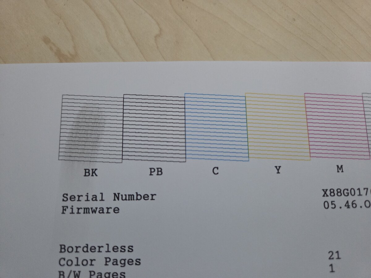

That´s a havy operation on your printer.I have an easy test how to proof if your PB chanel(ink) is conterminated(however you mix it ,the bottels are keyed) with BK ink (pigment).
You will print an nozzle checktest on plain paper ,then smudge with your finger on the PB test pattern ,...if it will smudge like the BK ink(pattern) ,so you have some pigment ink in your photoblack.
See on my picture.(i try it an bouth the BK and PB chanel but only the pigment ink will smudge)
And with the test you see if one or more nozzle are clogged.Only one or two clogged nozzels can deneutrolized your image.

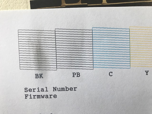

Smudge made with finger slightly damp:
What do you think? looks slightly smudged to me.
just put a drop of water on the nozzle print and let it penetrate by itself and see if you see a black ring after the water droplet has diffused through the paper: rubbing is not a good way to determine it. It should be done by passive diffusion to see.
No ,your finger must be dry ,better you use a clean dry cloth.
With damp finger the dye ink will also smudge/desolve.
