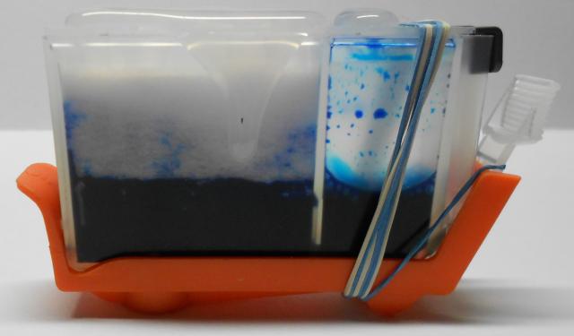

Thank you tudor for making the second CLI-8 video for me. Not too sure if you have throw away the existing CLI-8 in the 2nd video where you did it with hot glue.
Just a question (no need further video, because 2nd one is good enough for me to download), so the sponge absorbed unitl where it reaches about the grooves height (ie the lower sponge absorb the ink), there is remaining ink in the ink chamber, does it get further absorb by the top sponge afterall there is still ink left in the ink chamber?
Now assuming if you remove the hot glue from the refill hole, topup a couple ml of ink (while the vent is still sealed with hot glue as in your video), and then sealed the refill hole with hot glue again. After the hot glue at the refill hole is dried, remove the hot glue that was previous sealed at the vent hole and allow the cartridge to sit for 2 minutes or more if necessary, now did the top sponge gets to absorb the ink from the ink chamber? What is your observation like?
The cartridge is still fully closed with glue and clip. I'll let it sit like that until tomorrow, then remove the glue from refill hole, fill chamber with ink, plug and open the vent.

Well, you certainly demonstrated that well. I will cheerfully have to eat my words. It isn't the first time.
This is an unrelated matter, but the only other interesting thing I notice is that in the third video (cli-8 all plugged with hot glue), it looks like there's a lot of water left in the sponge. Starting at about 5:15 you can see it rising up in the sponge.

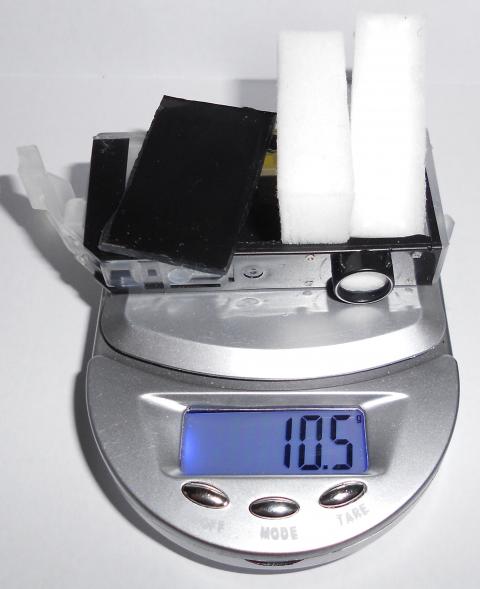

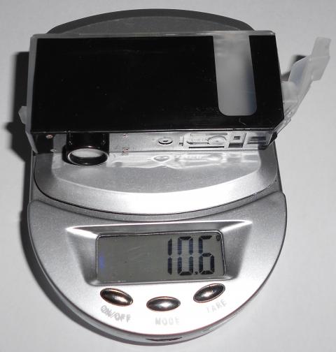

That's ink rising in the sponge. For some reason it chose to not touch the outer layer and, instead, infiltrate in the middle of the top sponge. I'm sure there was still moisture in that sponge, but 13,8g for an empty cli-8 is good enough (hehe).
This is how it looks now:
Aprox 0,1g of water/moisture remains in the sponges after centrifuging a cli-521 (that's 3 drops of water):
That means that, after refilling, the ink in the sponge contains 2% water/moisture.
Weight of the 2 sponges in a cli-521 - 1g
cli-8 - 1,3g
Can we assume that in a cli-8, after centrifuging it, we have around 0,14 g of water/moisture in the sponge?
