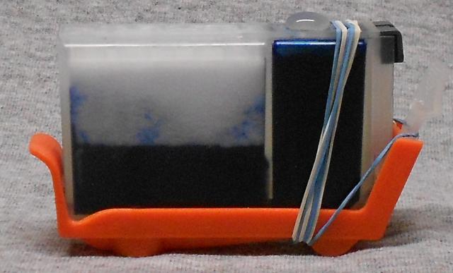

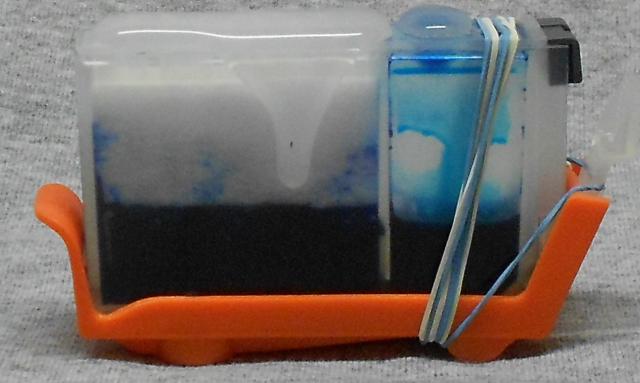

These are of the cli-8 with vent and top hole plugged with hot glue.
24+ hours later just before filling the ink chamber and opening the vent
48+ hours later, after filling the ink chamber and opening the vent
After I filled the ink chamber and opened the vent I left the cartridge sit for more than 24 hours and then took the second picture. The sponge did not absorb any more ink because the level of ink in the sponge was above the grooves.
