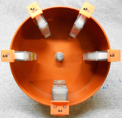

Excuse me for being a bit off topic, but I am very curious about the centrifuge. I also have a cordless drill and would like to try the idea: http://www.nifty-stuff.com/forum/viewtopic.php?pid=58965#p58965
So please Tudor, what is the diameter of the orange drum, and how many rpm is the speed of the drill, and how did you calculate the position of the cartridges? I see that you have compensated for the PGI cartridge being heavier than the CLI cartridges by the choice of the positions of the cartridges.
To calculate the g-force of your centrifuge see this: http://clinfield.com/2012/07/how-to-convert-centrifuge-rpm-to-rcf-or-g-force/
If your drill is rotating at 1000 rpm and the radius of the orange drum is 100mm, then the g-force will be approximately 100g according to the nomogram, meaning that your cartridge weighing 14grams will appear to weigh 1.4 kilograms. Is that green twist wire secure? And how about balance, is the centrifuge hard to hold due to vibrations?

@Peter

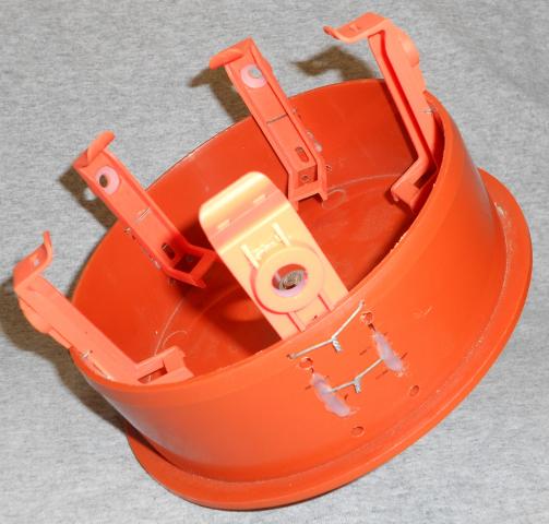

I don't have the equipment to perfectly balance the centrifuge, so there are small vibrations. As the rpm increases, the vibrations decrease in amplitude and increase in frequency. But... there are vibrations. So I don't use the cordless drill anymore, as it can be damaged. I now use a corded drill ( Einhell BT_ID 1000 E - a lot cheaper to replace) rated at 0-3000rpm with no load. I estimate the centrifuge works at about 2500 rpm.
It worked better than expected from the start, so I used it like that a few times. Until a cartridge took off... at 2500 rpm. I had to modify it a little and now works perfectly safe (so far :) ) .
Tell me if you want higher resolution pictures.

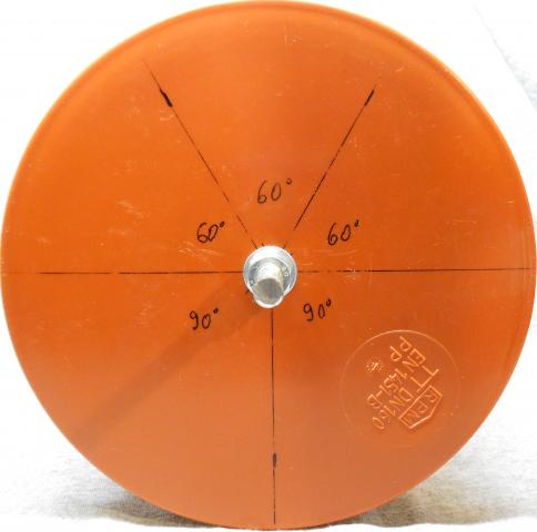

Orange drum inside diameter - 152mm
Orange drum outside diameter - 160mm
The centrifuge is balanced if you use:
a. a full set
b. 2 CLI
c. 2 CLI and a PGI
Oh, you may not see this in the pictures, but the part of the cartridge with the exit port is tilted to the outside. Just 1mm. That helps the liquid exit the cartridge instead of being trapped somewhere on the bottom.

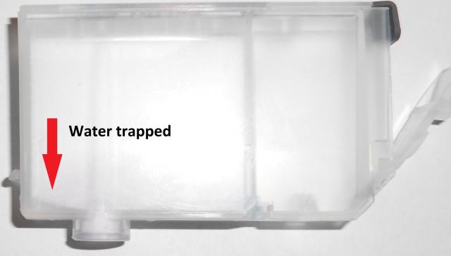

Here's a picture of a cli-8 after being centrifuged. Because these are clips for 521/526, the part with the exit port was too tilted and water got trapped. This doesn't happen with cli-521/526.

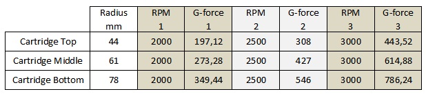

Calculated G-force:
Wow! That's a lot of g's!
