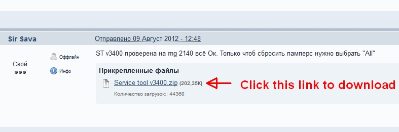

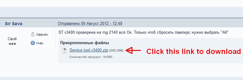

A download of version 3400 of the service tool can be found at this Russian site. For some strange reason this download does not work from a Google translate, but only from the original Russian site. To download scroll down to post #13 by "Sir Sava" and click the link in the post. See this:
AVG internet Security found nothing wrong with the service tool and it works. The download also contains a text file in Russian. It is an instruction for entering service mode. See this post for the translation.
Edit: Malwarebytes Antimalware blocks access to the Russian site due to a Trojan. Download at your own risk.
Nice One @PeterBJ ive downloaded and copied the translated English instruction you mentioned, saved them into a .txt file and repacked the file to a .rar to bring it in under 200kb so it can be attached here for users :) ....
  • Service tool v3400.rar
