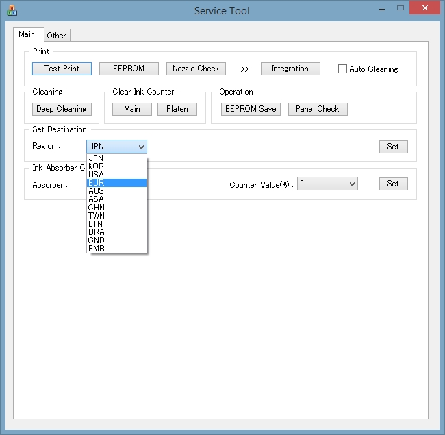

I can get into service mode as you describe, 3200 downloaded a long time ago when I tap print I notice region is JPN Japan? I have tried to download fresh versions but Google blocked the download, something about security. I have also taken the L/H end of completely. This enables me to raise the lid right up with a wedge. Carriage moves smoothly from end to end gave a good clean around the park and wiper blade positions with Window cleaner. The M/C is definitely doing a lot of cleaning cycles and there is also clicking and clunking sounds I never heard before. But the parking pads/rubber gasket seem fine, unless a tube has fallen off?.
So at a loss this error why comes and goes which indicates to me that it cannot be anything very serious. There are 4 HP and 1 Brother printers in our family, but they all use original carts. Perhaps I will look in that direction. If I cannot resolve this problem. Thanks again

Your previously downloaded service tool v3200 is OK. A version 3400 that is also OK can be downloaded here, it is a rar archive that needs to be unpacked before use.
Newer downloads of service tools from the web are often infested with malware. It has become risky searching for service manuals and service tools.
The "JPN" button is actually a drop down menu from which you select the region you want to set the printer to, click to enlarge:
