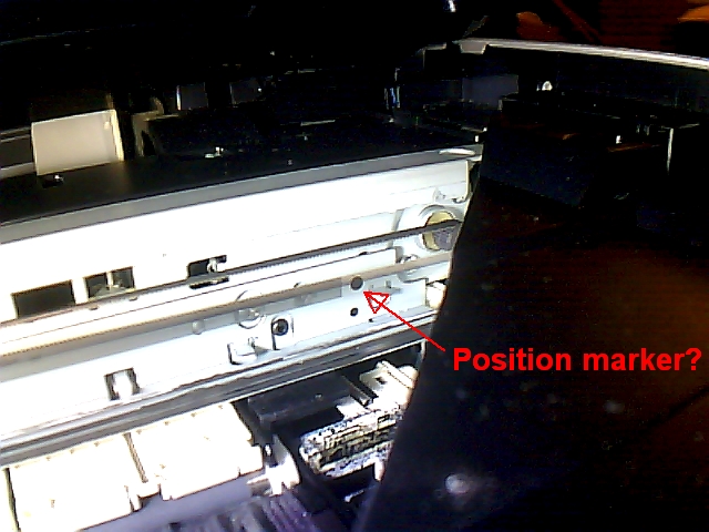

I have an MP620 and I used a webcam to shoot a photo of the right hand side of the timing strip. At approximately 7 cm or a little less than 3" from the end is a black circular dot with a diameter of approximately 5 mm or 13/64 ". I think this is a position marker of some sort:
Does your MP620 timing strip look like mine?
Yes have the round dot but about 2/3" to the left is another odd shaped mark irregular in shape I can only describe it as like an egg timer but tilted about 45 degrees with jagged edges. Tried various cleaners but cannot shift it. May try a Canon Service Center to see if I can get any information.
